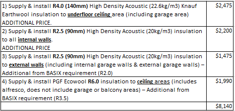

Hi @Samara1,
To clarify, are these costs for upgraded insulation from what is currently specified, or is there no insulation and these are the prices to install it? 1) and 2) appear to be insulation in areas where there is currently none planned, and 3) and 4) appear to be upgrade costs of the already planned insulation.
Out of the list, I would prioritise 3) and 4) as insulation in the external walls and ceiling is important to stop heat transfer into the internal spaces. 1) and 2) help insulate the top floor from the bottom and individual rooms. These are of lesser importance but still will help isolate areas, leading to more efficient heating and cooling of the spaces. Being acoustic insulation, they also assist with noise transfer between rooms and floors.
If you've already paid for insulation in the external walls (R2.0) and ceiling (R3.5), which are the requirements, it could be worth leaving them as they are and adding insulation in the underfloor ceiling and internal walls, where there is currently none. That way, you'd have an entirely insulated house.
The question is whether you want to invest in upgrading to thicker insulation in the important areas or sticking with the basic requirement and investing in other, less important areas with no insulation. You're not getting a huge upgrade in the external walls R2.0 to R2.5, but the ceiling is quite substantial R3.5 to R6.0.
It's a bit hard to tell you what would be best. I'd encourage you to try and do 1), 2) and 4). 4) would make a substantial difference in preventing heat transfer from the roof cavity into the upper level.
Great thanks @MitchellMc well explained.
you are correct on the points 1 (underfloor insulation) & 2 (Internal walls) are new additions and both are HD acoustic insulations.
3) External wall upgrade from R2.0 to R2.5 acoustic insulation & 4) ceiling upgrade from R3.5 to R6

i want to avoid noise at the max, by adding acoustic insulation between floors and internal walls.also i need to decide between these two options for undefloor ceiling, first one is 32kg and second is 20kg: here thickness does not matter between R2.7 (90mm) and R4.0 (140mm), only the density? both are HD suitable for acoustic right, then how R4.0 weights less but more R value. R4.0 (140mm) HD gives the same acoustic (same) but more thermal than R2.7 HD here? price diff between this two is $275
which one to go for here.
1) Supply & install R2.7 (90mm) High Density Acoustic (32kg/m3) insulation to underfloor ceiling area (including garage area)ADDITIONAL PRICE – $1,975.00 + GST.
2) Supply & install R4.0 (140mm) High Density Acoustic (20kg/m3) insulation to underfloor ceiling area (including garage area)ADDITIONAL PRICE – $2,250.00 + GST.
Hello @Samara1
If the insulation provides the same level of noise insulation, but the more expensive one has a better "R" rating, then that's what I would recommend getting. On the condition that it fits your budget, getting the more efficient insulation would be the smart investment.
