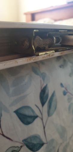

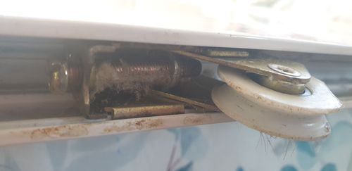

Hello! I'm trying to remove these wardrobe wheels so I can replace them as the wheels are all broken. I've undon the screws at the end but they still done come out. They seem to be an upside down hat shape but can't see how to get them out?

I believe that the particular wheel assembly that you have was installed by sliding it into the bottom rail. This means that the bottom of the wardrobe frame must be taken apart to allow you to slide the old wheel assembly out.
Once you have the wheel assembly removed, make sure to bring it to the store so that you can compare it to the Cowdroy Wheel Assembly sets available. One other option is to see if the wheel of the old set can be safely removed. If it can be removed, I suggest bringing the wheel to the store for comparison.

Have a good look at the end of the corner, there will probably be either screws or blind rivets holding the assembly together.

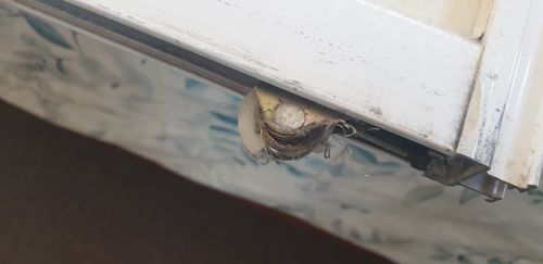

Did you end up removing the wheels @DIYbec1 ? I have the exact same type and am worried about breaking the glass mirror if I have to remove the frame to slide the rollers out.

Hopefully, @DIYbec1 managed to find a solution that they can share with you. I'd certainly recommend you enlist the services of a professional if you have any concerns about the glass breaking while removing the carriage. Remember to wear PPE, including cut-resistant gloves, protective eyewear, a long-sleeved shirt and trousers and enclosed footwear.
