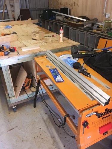

started of with triton workcentre 15 years ago but have moved around alot in my life being in the armed forces
so have settled down now and doing what i love best

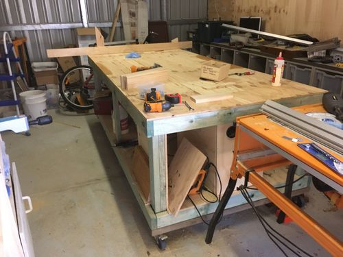

anyway found that cutting full sheets was painful so made some outriggers for the triton so can do full sheets the thought i need an assembly table to build things on and an out feed table as well so made the bench behind the triton is on lockable wheels but can be moved out if needed
The out feed table has a small area where in can take out an either put in a jigsaw a sander or a small router

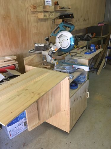

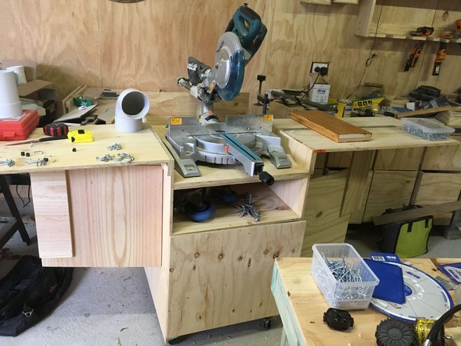

my next project was making a mobile drop saw table pictured below
drop saw
well it works well for what i needed at the time

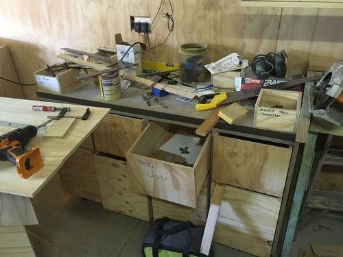

next i needed to a cupboard and small workbech for storing stufff in

anyway some poeple have been asking me for measurements and stuff of the drop saw table so here we go
the photo is of the large drop saw table
have some rough measurements for you
Wings 850mm x 500mm x2
wing arms 500mm x 500mm x 2
Cabinet sides 900mm x 730 mm x2
Shelves 600mm x 730mm x 3
(1shelf is the floor of the unit and 1is for the top of unit and 1 for top of door you can cut another shelf for inside the unit if required)
Back 1000m x900mm
Door 520mm x 615 mm
All measurements are rough

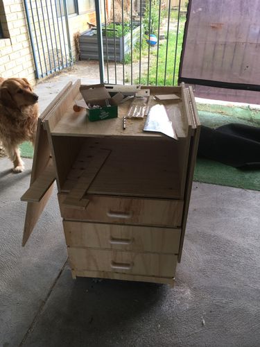

Ok below i have some measurement of a smaller version with drawers
small 3 drawer model
Measurement are a guide only
wings 700 x450
shelves 480x490
sides 900 x 500
Back 900 x500
drawer fronts 150 x520
drawer base 490 x435
Drawer sides 120 x435
drawer backs 490 x120
all these were made out of scrap 12 mm plywood
