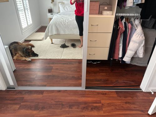

Hi experts
do you know how I can change this broken cupboard rail?

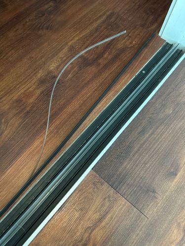

It looks like the aluminium fin at the back of the bottom track has come off. Is that correct?
If this is the case, you will likely need to replace the bottom rail of the sliding door, which wouldn't be too difficult as long as we can match it up with the door system.

What a pain 😕 I cant see how it was attached from your photos, Is there any chance of a closer up photo or two especially where it joins the original base inside the cupboard? If its that rough silver edge next to the timber flooring on the inside then Id say the whole strip needs to be replaced as the outer rail is a guide 😕 Depending on money you could potentialy install an right angled alumininum strip so the high side is in the same postion as the old black strip and the flat base screwed to the inside floor. Something along one of these types Aluminium Angles Even to the point of glueing the one that is half off against the new side to give the correct spacing. Think L with the highside facing the channel of the door. I dont know if this would hold up for a long time is my main concern.
If not possible Id start searching for "Sliding door Mirror tracks" in facebook land. You will start to see adds soon enough of people getting rid of theres and if you are lucky you could see your strip. (Love facebook algorisims, make them work for us for once!)

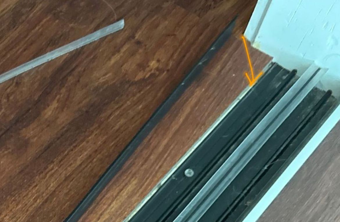

Hi @Dave-1 it looks like the track is okay but it's the guide/buffering track on the extreme outer edge that has come off (see enlargened image below), the piece to the extreme right appears to be a cover (possibly to hold a piece of felt against the door) which fits over the piece next to it which looks to insert into the track in some fashion...
interference fit?
adhesive?
It looks too uniform to have simple broken/snapped off.
I am not familiar with this type of sliding door track.

Evening @Dave-1 I note that the slot adjacent the LHS track is occupied on the RHS tack as these should be a mirror image of the other.
