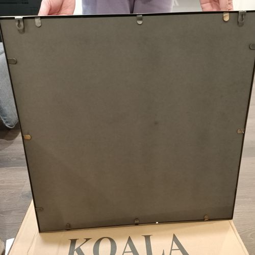

@JacobZ thanks for that. I'm hanging a few of these mirrors in the main living area, so I don't want the hooks to show once it's hung. Which one in the pic is best for this job ? Thank you
Of the three products you've taken photos of, I would select the Ramset Super Wallmate toggle anchors on the right.
These anchors, as they are rated up to 20kg, are better at bearing a load than the other two and will be well hidden once the mirror is installed.
Let me know if you need assistance with anything else.
