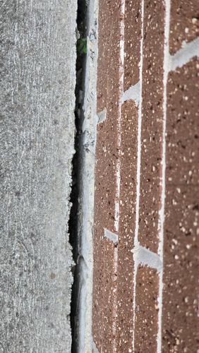

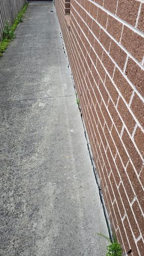

The side concrete has move over the years and now has a little gap against slab. I am thinking to use Dunlop Ardit to fill that gap. Any other suggestion to fill the gap. Also I will be doing this first time. So any tips will be helpful.
Hi @patelsanket10,
My advice would be to stuff Ableflex into the gap and cover it with Sika Concrete Grey Sikaflex Pro+ Polyurethane Sealant. You'll also need to pick up a sausage style caulking gun if you don't already own one.
Because concrete expands and contracts with temperature changes, a rigid substance such as Ardit will crack quickly. The flexibility of the Ableflex and the Sikaflex Pro+ will cover the gap while still allowing for expansion and contraction.
Have a look at How To Silicone a Gap as an example of the process. The scale is much smaller, but the principles are the same.
