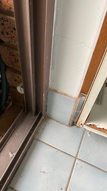

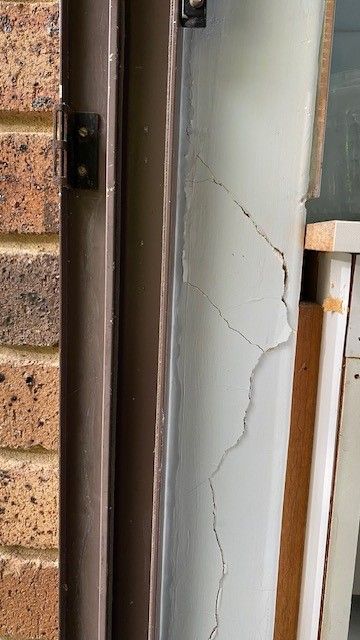

Hi there Guys - I am renovating my 1980s laundry and the double glass and alumenium sliding door frame has movement as the sliding door opens and closes. By grabbing the end frame where the door normally latches, movement is evident. As a consequence, the plaster sourounding the frame is badly damaged. I feel I need to fix that frame so it is without movement before tackling the plaster issues otherwise the new plaster will go the same way. Any ideas on how the frame was originally fixed to the brickwork would be helpful as well as ideas on how to remedy? Greatly appreciate any advice.

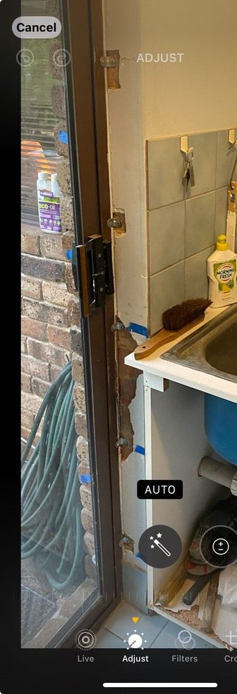

Thanks for all the positive suggestions and I'd like to report that the job is done after taking on the combined knowledge. Thought I'd post a picture to finish it off for the post and you can see how I fixed several angle brackets at intervals from bottom to top with a masonary anchor into the brickwork and a big fat rivet into the alumenium frame which is hidden behind the frame. Plaster will cover the part on the wall and touch up paint on the part attached to the frame. Solid as!Door frame now solid.

Excellent repair work on the door frame, I'm sure that the brackets will hold the frame in place securely.
Morning @terrytoons
🙂 Nice work, would be a reliefe not to have a shaky door anymore!
Thank you for showing us your solution 🙂
