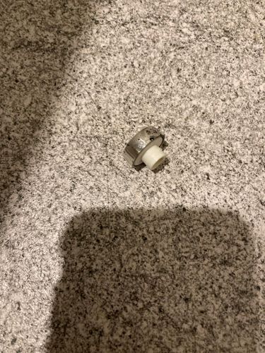

What are these tiny holes on the toilet? Is it okay to seal them with silicone?
Some of the toilets in the house have plugs that cover them. Does anyone know where I can get replacement plugs?

Those little holes are access points for the anchor that holds the pan to the floor. If you flash a torch inside, you'll see the pan screw heads. The silver caps are just basically hole covers, I suggest bringing one to your local store and asking the special orders team to get some in for you as spare parts.
