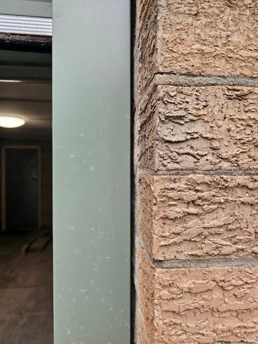

Hi I noticed rain water leaking on the inside and want to know the best way to fill the gap. The roller door frame is standard colourbo
nd.
Any advice is much appreciated.

Depending on the width of the gap I'd suggest using a combination of Ableflex and Sikaflex Pro+. You'll also need a caulking gun such as this Paint Partner Aluminium Caulking Gun to apply the sealant.
It doesn't look like it is, but if the gap is over 10mm, you might have some trouble getting the Sikaflex Pro+ to stay in place. If this is the case, stuff Ableflex of a suitable size into the gap to act as a backing to keep the sealant in place.
You might like to check out How To Silicone a Gap. The circumstance is different, but the principles are the same.
