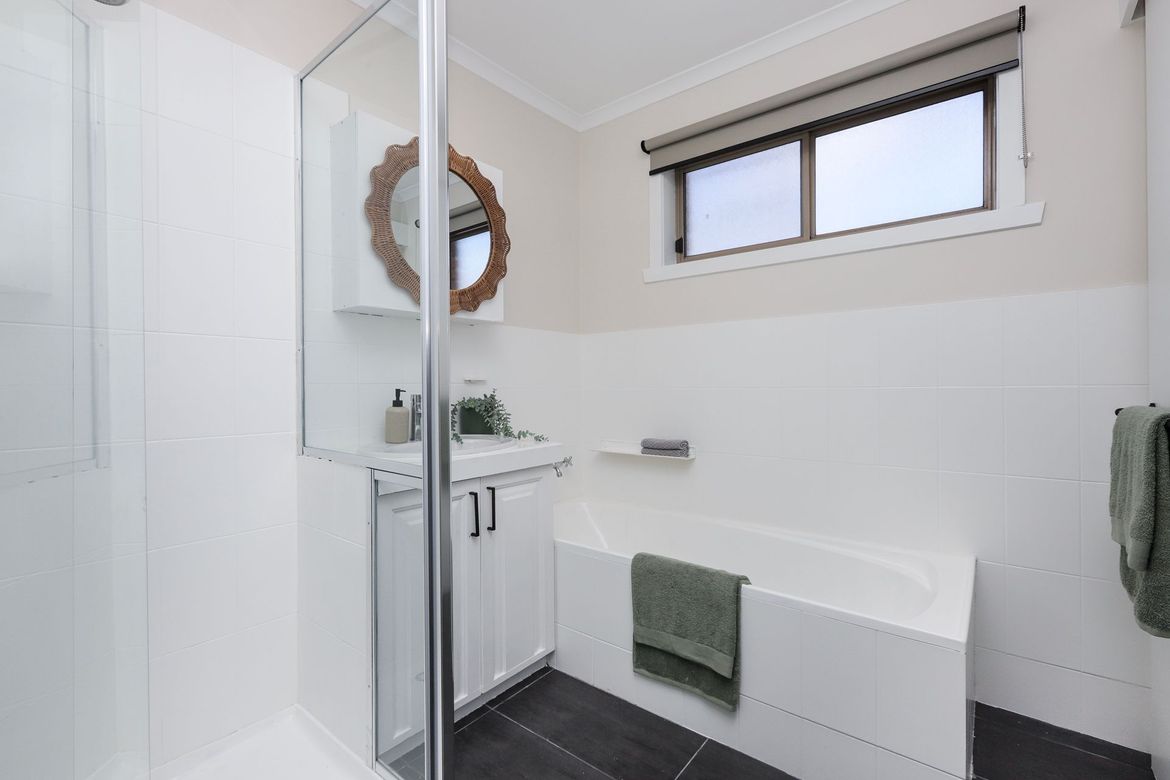

This is my bathroom that I've been renovating.
New shower screen
Painted the tiles
Fixed the cabinet and attached a mirror
Painted bath and shower base (tub and tile 2 product paint)
Removed cabinet doors, painted them and attached new handles.
New sink was installed
Painted around the sink (laminate paint)
Hi @Dani29,
Thank you for sharing the updated images.
You must be so happy with the outcome. Everything looks fresh and clean, like brand new.
Congratulations on a job well done.
