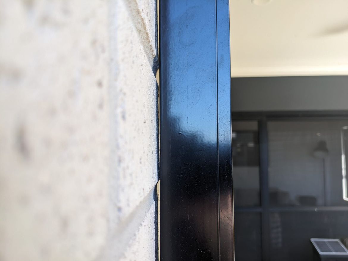

Could someone please recommend a product to seal between this blind frame and bricks? The gap is slightly smaller on the other frame. It will be visible so would need to be look good

I suggest having a look at the Sika 300ml Black SikaSeal Kitchen And Bathroom Silicone Sealant. It is a neutral cure sealant which will not harm the paint surface of your frame and can be applied to a variety of surfaces. My best advice is to make sure that the surface of both items are clean and free of debris before you start applying the silicone.
Here is a handy step-by-step guide: How to silicone seal a bath. (the techniques used are applicable to your project.)
