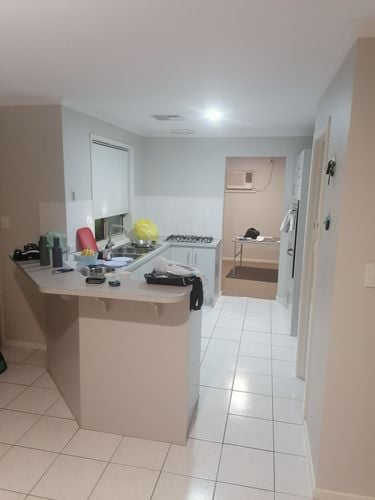

Starting to do your own kitchen can be daunting and confusing for first time, the thing to remember is to take it step by step not as a whole project, although planning of steps is key.
With bunnings planning is much easier and they will give you the $99 design fee back if you proceed.

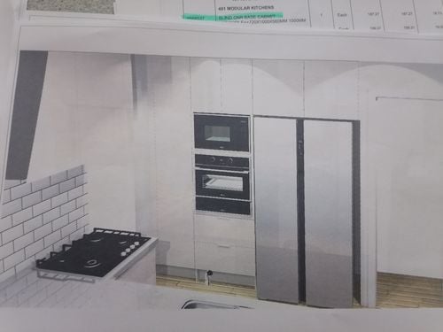

Step 2

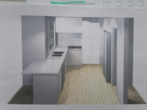

Get a design completed that suits your space and finalise the cost, remembering any electrical and plumbing requirements, such as if you are adding a induction hob you will need a new cable run to suit the power draw.

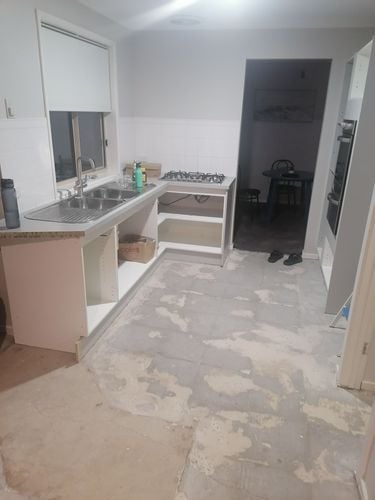

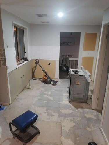

Remove kitchen, using trades if needed makes things easier especially for first time installers.
Cap gas and water connections
Remove cabinets, alot of people use hammers and break cabinets, but depending on age, a screwdriver bit on drill is cleaner and easier to remove cabinets into bits, just keep a hammer to dismantle when needed.

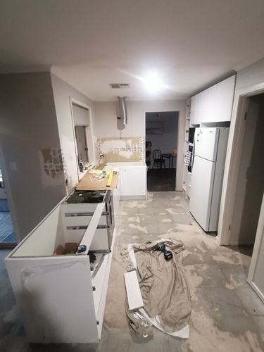

Step 4

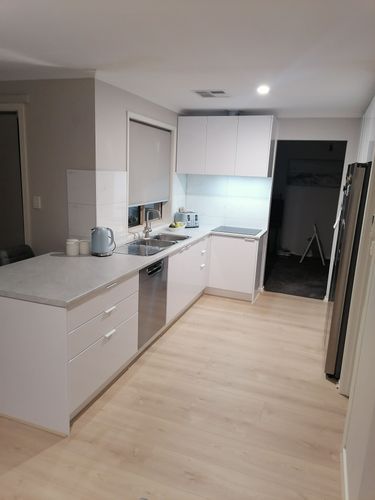

Once you've got a clean slate, get your cabinets assembled, take your time and ensure legs are correctly positioned, a tip on tall oven units, to fit legs it's easier to assemble unit and lift onto some wood to elevate. Also the metal side strip's don't allow most ovens to fit so I'd leave them off.
Step 5

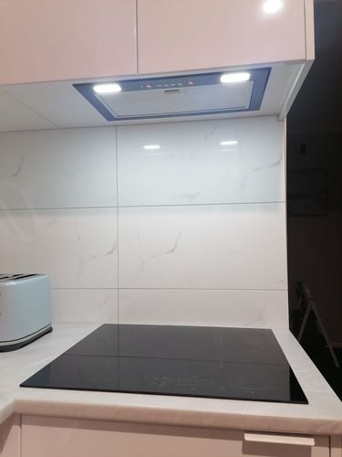

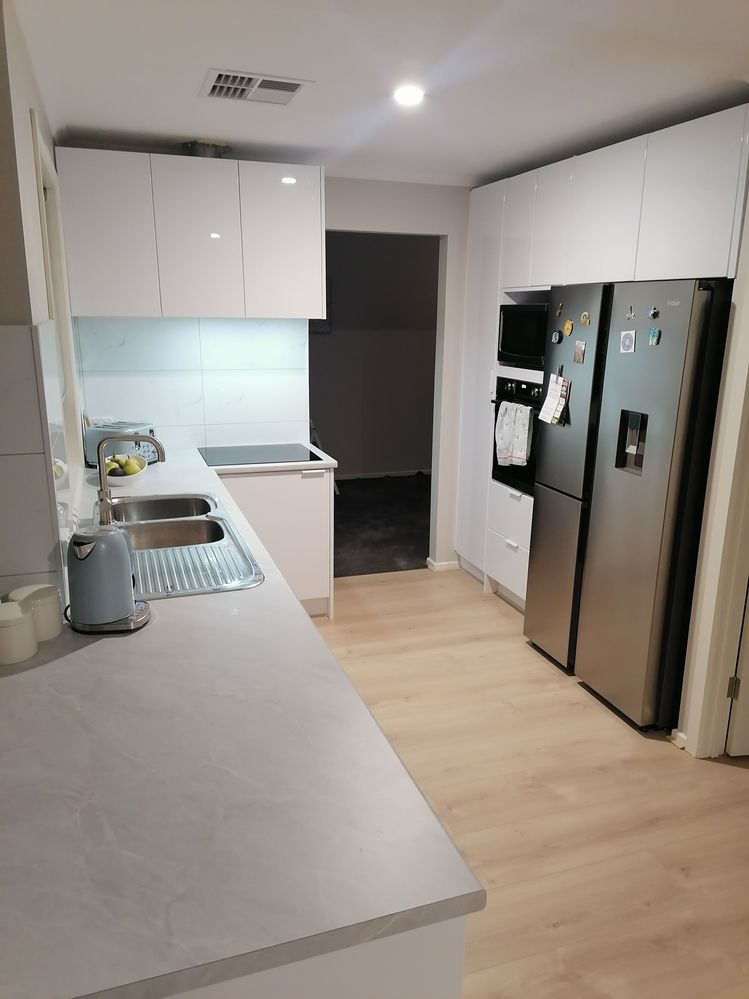

Completing your design process is bench top and splash back type.
Bench tops can be tricky lining up and cutting so getting a local trade to do your top will make life alot easier and sometimes cheaper overall.
Step 6

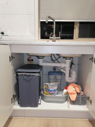

Good design will make sure your kitchen becomes a welcoming space that is the ultimate in function, good appliances makes all the difference, such as added benifits like hob to hood range hoods that operate automatically and dishwashers with top cutlery racks or overs with built in air fryers. The right type of bin also adds functionality and quite often a good price can be found online.
