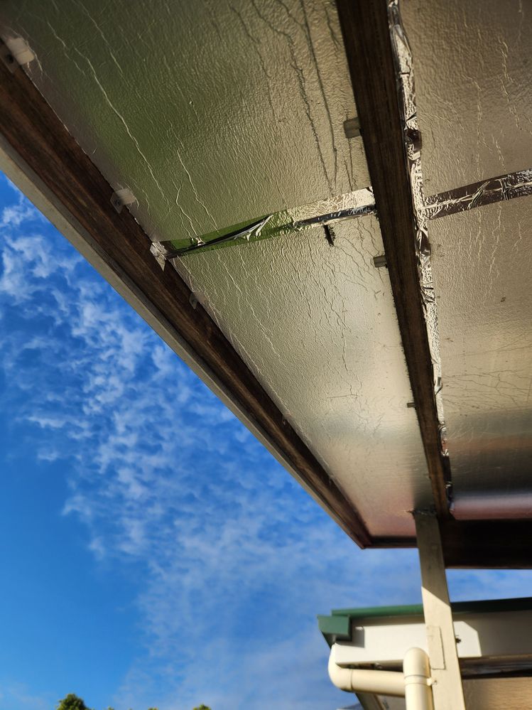

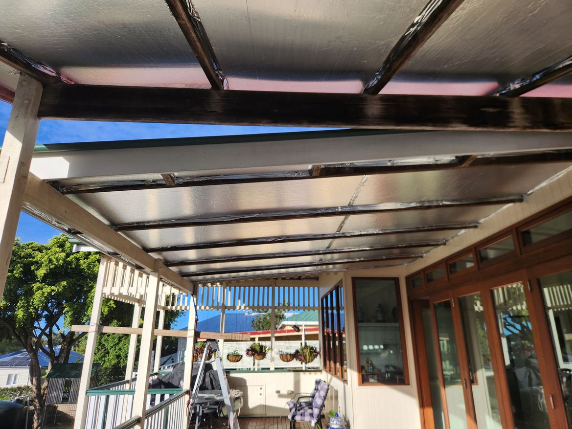

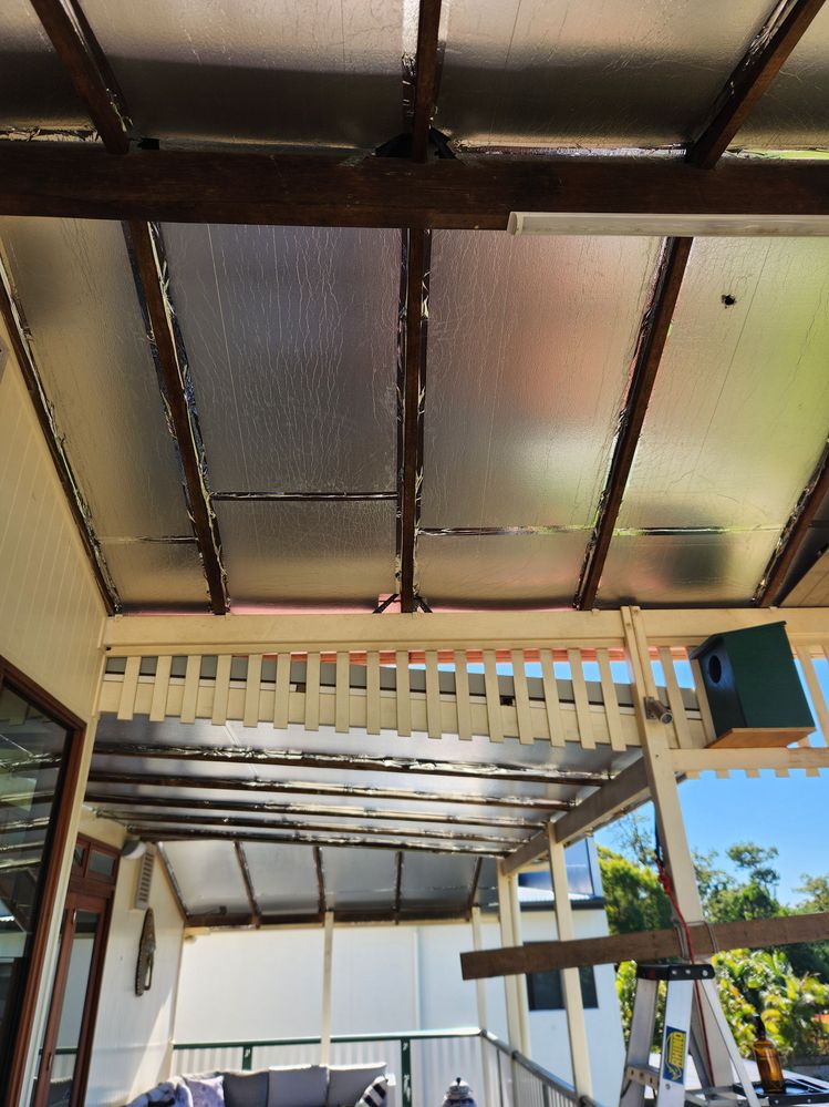

Looking to install a timber (or look alike) ceiling into rear deck on Queenslander, which has four different slopes. Have to make it possum proof. Rafter spacing approx 900mm. Approx 300mm space for soffit (none installed). Foilboard insulation installed, which has made deck usable in summer, but intend to add some more rockwool or similar. Looking for advice on suitable cladding products, and how to install. My thoughts so far:

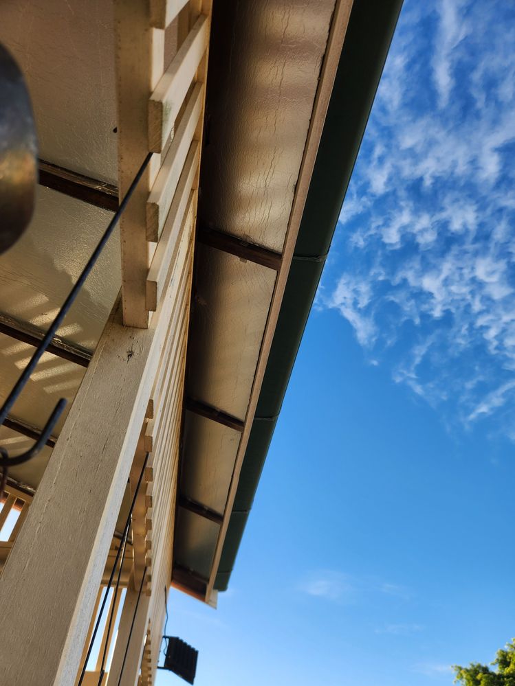

soffit - too hard to use timber product, so thinking colorbond flat sheet screwed direct to rafter on slope and hope it doesn't sag too much. Note: fascia board groove is partly obscured by rafter, which I could chisel out to make soffit slip inside groove. could screw timber block on fascia at rafter mid point to support soffit, but hard to do on roof beam as second floor deck means everything must be done from the deck.
cladding: Permawood, perhaps pine (Bunnings site says indoors), ply (might be heavy for me to lift)
how to support cladding: thinking metal "top hat" as used for ceilings at 450 centres, and notched to sit flush with rafter. Two fixings per rafter. (?can I nail cladding into this metal top hat?). This would make the cladding run the same direction as the rafters. Is there another solution?
