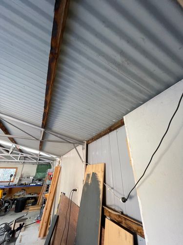

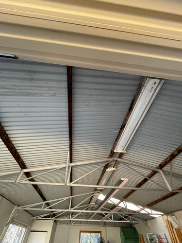

Hi there, apologies if this has already been answered, couldn’t find any post on this already. I am going to follow the advice found here. Here are some photos of my garage.

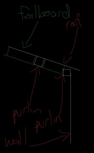

I want to install foil boards to prevent condensation forming in the ceiling of my garage shed. 1st question is, how do I best seal the edges, especially for where the roof ends and the wall starts. I’m concerned some condensation might drip off and fall back into the garage.
2nd question is, I would like to clad the ceiling once I have been able to put all the foil board up. What would be the best cladding? I do like the look of plywood but understand it’s heavy. Would something like plywood work?

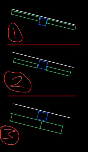

Finally, I was wondering whether I should install more purlins to take the weight of the foil board and the cladding. If so, how should I fix timber purlins to the metal bracing? Any advice on this would be awesome.
