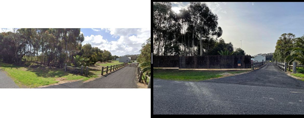

Replaced standard farm fence with Brush Panel Fencing
Hello @Grant777
Thanks for sharing your brush panel fencing project. It looks great! Can you please tell us a little bit more of how you built it? Did you have to put new posts and rails? How did you attach the brush panels to the frame? How long did the project take to build?
Hi Eric,
Yes, I needed to dig holes, place all new posts and rails for the brush fence to attach too. I had zero experience with these fences but after viewing a few YouTube videos it went together smoothly.
The brush was attached using 50mm tech screws, all posts and rails also tech screwed (not nailed) which gives flexibility should I make a mistake and add strength.
Each hole was 1m and used concrete to secure them.
By the time I removed old farm fence, prepped, dug holes and finished took 2 weeks part-time single handed.
