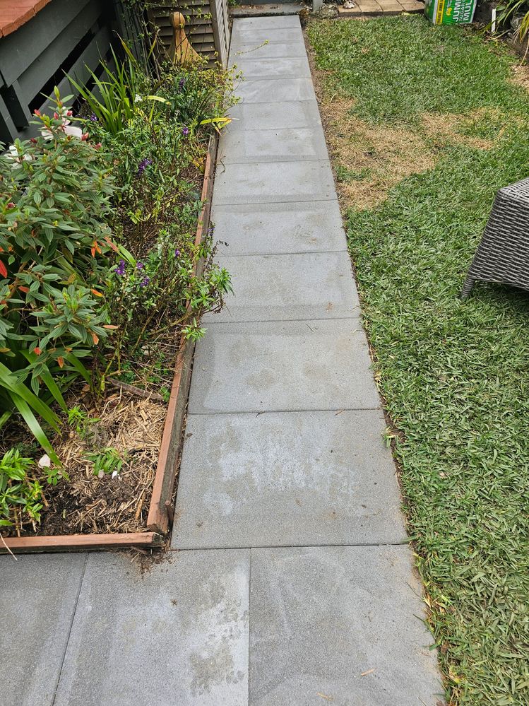

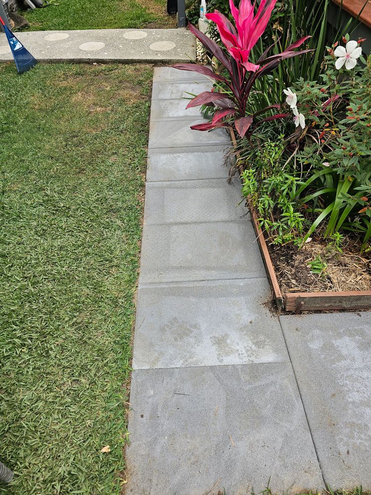

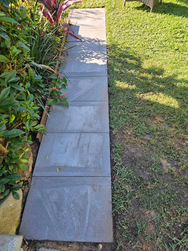

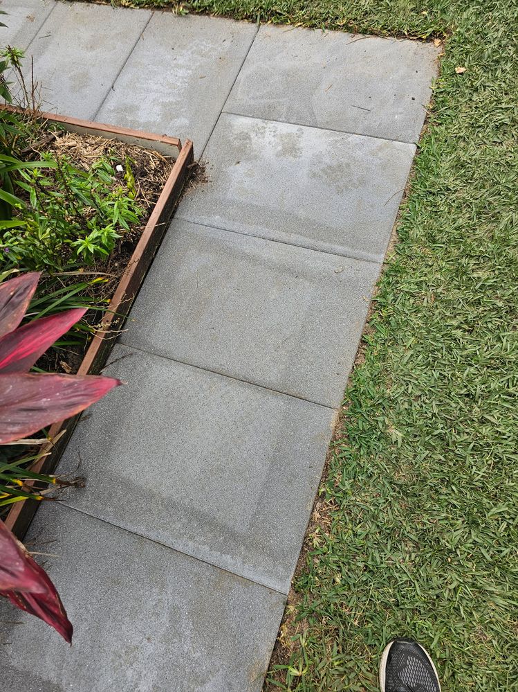

Hi All
I just bought these and paid to have laid, what can be done about this discoloration so very dissappointed.

From these new photos, I'm fairly certain that you are seeing a bad case of efflorescence.

Is it possible to get some more photos of the pavers from closer? Is the discolouration powdery?
It's possible that this may be efflorescence, which is fairly common with concrete pavers.
It occurs when water dissolves mineral salts within the concrete. It is then brought to the surface where the water will evaporate leaving the powdery salt residue on the surface of the paver.
Efflorescence can usually be cleaned using household vinegar, which may be the most cost-effective place to start.
If this is not a solution, we can't rule out an issue with the actual pavers.
Can you advise which specific paver you have purchased so I can investigate further?
Let me know what you think.

I doubt that happened in transportation every single paver (21 of) looks like that. I will spend more money on the paver cleaner and see what happens.
It does not seem right that I should have to do this.

I'm sorry to hear you are disappointed with the quality of your new pavers.
The discolouration is possibly from the pavers scraping across each other during transport. It may just be concrete dust, that can be removed by cleaning the pavers with a cleaning chemical and scrubbing brush.
You might like to start by using Chemtech Brick Tile And Paver Cleaner alongside an Oates Long Handle Deck Scrub Brush to try to remove the discolouration. Give them a good scrub and then hose them down to remove the cleaner and anything that comes free.
If you don't have any success with this method, you may need to use an abrasive such as these Flexovit Wet and Dry Sanding Sheet. Wet the pavers down and apply pressure in a circular motion. This should remove the very top layer of the pavers which will give the surface a more even finish.
Please be aware that you will be creating silica dust, so ensure the pavers are suitably wet down and wear a mask while sanding.
