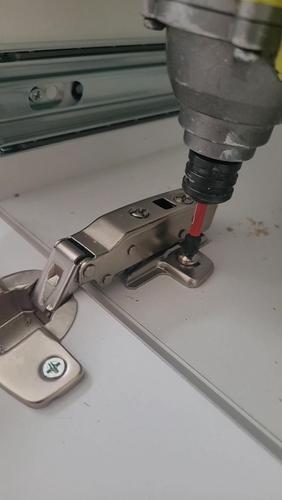

If you're planning to do a pull down door like us, I would suggest using hinges that have an opening angle between 90-105deg so that the door doesn't drop down too much and the hinges should be about 100mm from the side edges.
If you have an existing cabinet with normal doors that open sideways, what you could do is add blocks behind the hinges and start your shelf in between the blocks and I would also change the door hinges to full overlay hinges.

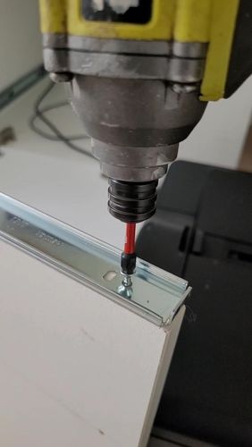

Step 4

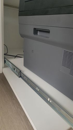

Now that you've cut your pull out shelf to size, fix the ball bearing runners on the shelf and to the cabinet sides. I've installed the shelf about 100mm above the hinges
Step 5

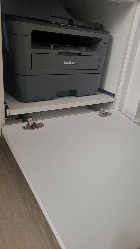

Install your pull out shelf and place your printer in place.
We made sure to build this cabinet close to a power point to the cables could be hidden inside the cabinet so this is something to keep in mind
Step 6
And here you have it! Super easy DIY that I'm sure will help you a lot. When we need to use it, we simply open the door, pull the shelf out and turn on the printer... it stays connected and we can turn the power off from underneath the desk
