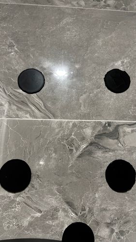

Builder installed mirror fell after 2 years and I am trying to install a new mirror now. But I am unable to remove existing silicon that was behind the previous mirror. Any ideas to easily remove these?
Hi @pc007,
Thank you for your question about removing silicone from tiles.
I'd suggest starting by grabbing a 100mm Sharp Edge Paint Scraper.
Run the scraper along the tiles at a 45-degree angle to the tile. You'll likely have to use quite a bit of force but stick to it, you should be able to get it off. Make sure to wear gloves and a long sleeve shirt to prevent any potential lacerations.
If you don't have any luck with just the scraper, you could grab some Selleys Silicone Remover.
Apply the silicone remover, following all manufacturer's instructions for use and then use your paint scraper to remove the silicone.
Let me know what you think and if you have any further questions.
Thank you JacobZ. It was easy to remove with scraper. Now I need to install mirror. I’ll follow Bunnings video. If you have any tips, do tell. 😊
