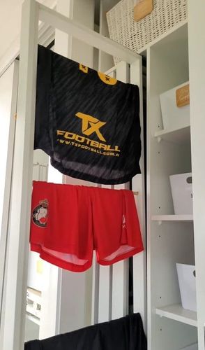

The point of these drying racks for us to use them during winter mainly, where we wouldn't be able to use an outdoor drying rack. We would most likely use heating in the house when it's cold anyway, so I would then minimise the use of our dryer and use the racks instead.Â

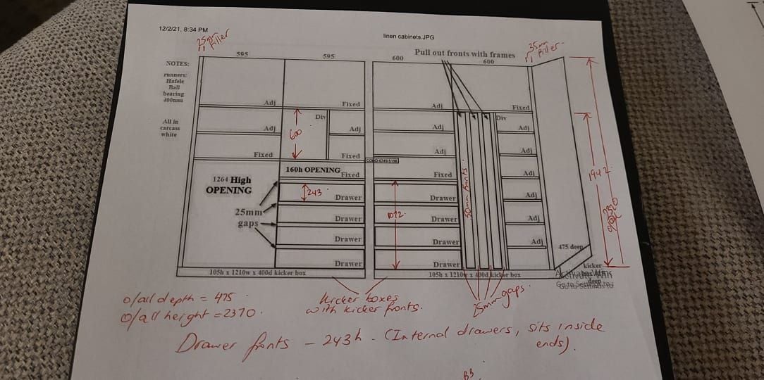

I had already done a sketch of where I wanted these racks to be so all I needed was to make sure the heating vent was in the right spot.
Here is what I sketched up 😊

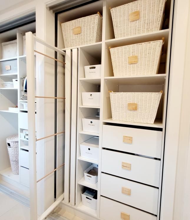

What I tried to achieve was like a fingerpull look but verticallyÂ
The fronts are edged all the way around and the frames behind the fronts are about 5mm smaller from each side.. so 40mm wide.
I wanted to try and have both shelving and pull out drying racks so the space I had was very small, only 250mm. But if you have a bigger space, instead of 25mm gaps, go with 80mm or more if you can so you can use them for thicker clothing like jumpers, jackets ..etc
I also initially had the idea of drilling a series of holes from top to bottom so the dowels could be adjustable but as i built the frames I realised that it needed support from the middle so I ended up making them all fixed so the frames would stay square.

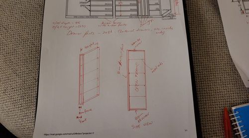

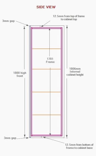

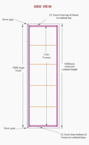

The hard part was to determine what my frame size needed to be so here's the sketch I used to determine my measurements

Cut all your rails using white melamine board the edge them all around to seal them from moisture
Before you assemble the frames together, mark where you want your dowels to be (ours were roughly 437mm apart)
Once you worked out your heights on one rail, repeat the marks on all your front and back rails so they're all equal and consistent... drill all your holes and then assemble the frames.Â
You will need to assemble them with the dowels in, it's much easier that way. Don't forget to measure both diagonals to make sure your frame is square

 - Cut a 3mm packer and another one for the gap you will have between your fronts

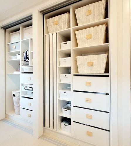

And here you go, you've got awesome space saving pull out drying racks for not even $100!!
