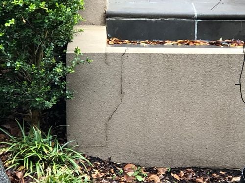

Hi Bunnings! I’m hoping to repair some cracks in a rendered retaining wall out the front of our house. Picture of one is attached. The render has a consistent sandy textured look/feel. Have read lots of posts on the topic so have put together this plan I was hoping you could look at and guide me:
1 - Widen cracks and remove any loose debris
2 - Fill gaps with mortar (I have some Australian Builders Mortar mix - will just use a small amount)
3 - Use a sponge, toothbrush or paintbrush to match the texture to disguise the patch
4 - Once dry, clean whole panel with vinegar water mix
5 - Prime with DULUX texture med
6 - Paint whole panel with DULUX texture exterior - linseed
Am I on the right path? Any suggestions?
