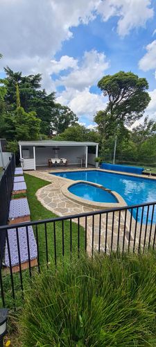

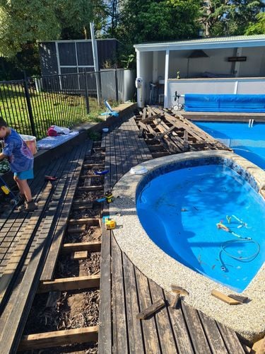

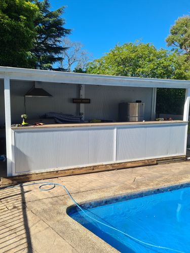

Pool area restorationMy old pool area had treated pine decking which was cracked and splintered. It also had a bar which blocked off the undercover entertaining area. I knew from old photos there was slate underneath the decking. I decided to pull up the deck and restore the slate and remove the bar to open up the space.

Step 1

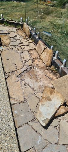

Pull up old deck

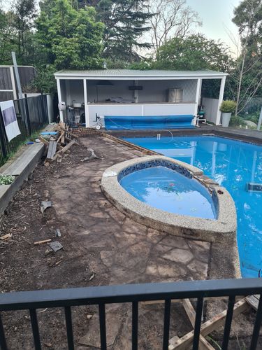

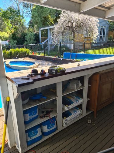

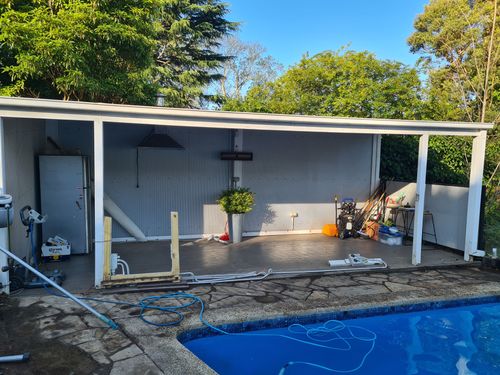

Step 2
Remove bar

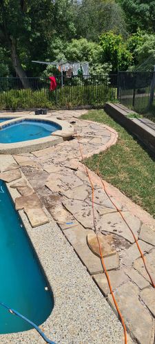

Step 3

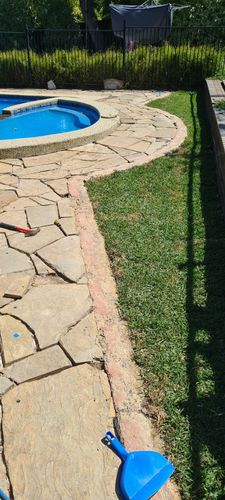

Clean slate
Step 4
Add grass to the area the slate didn't cover (old garden bed)
Step 5

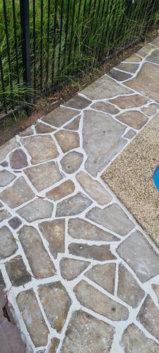

Remove old grout
Step 6
Glue down pieces that lifted
Step 7

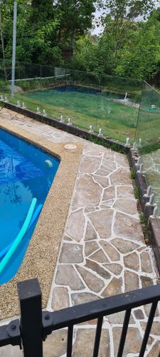

Remove all debris and regrout
Step 8
Clean off any grout residue.
Step 9

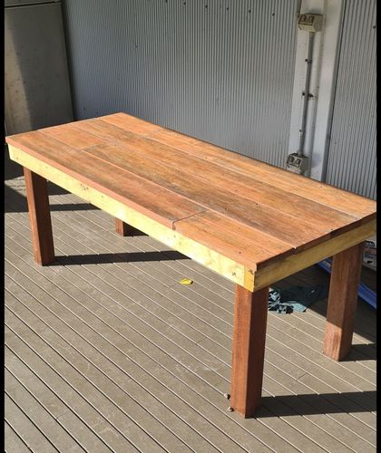

Build table reusing materials from old bar
Step 10
Sit back and enjoy!
