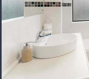

My bathroom sink has come unglued and needs to be glued back. Would Sika 290ml Sikaflex®-118 Extreme Grab Construction Adhesive be the correct product to use?

I've been in contact with the technical team at Sika and they suggest using the Sika 290ml Sikaflex®-111 White Stick & Seal Construction Adhesive - White. It is a much safer product to use on acrylic surfaces and when bonding porcelain products.
Here is a handy step-by-step guide: How to silicone seal a bath (some of the the techniques used are applicable to your project)
My best advice is to make sure to apply some of the silicone under the lip of the basin if possible.
