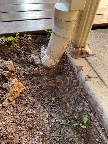

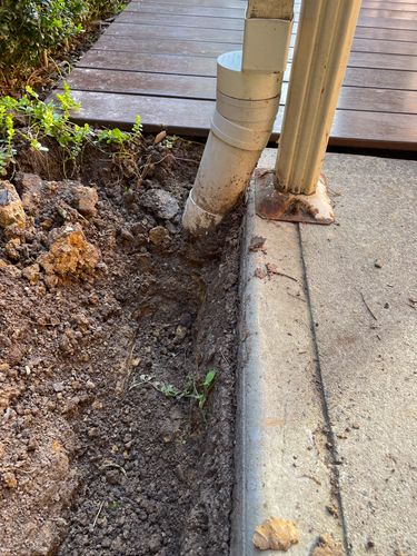

Hi All, I’m trying to connect Agi pipe to the stormwater drain as shown in this picture below. I’m new to this so I’m wondering how can I do it? Thank you!

Before I ask a plumber to connect it to the stormwater pipe, I dig the trench myself. Just wondering should I dig until the agi pipe is at the same level of the stormwater pipe? Or dig as deep as 30cm as suggested and plumber has no problem to connect it?

I am digging along the blue line, but as you said, the other end might not be high enough to let the water run down to the stormwater pipe. If I dig along the red line, I'm worried the agi pipe may not be effective enough to take the water, as this area has a slight slope, the red line is a bit higher than blue line. So which line do you think is better to dig along?

If the slope is towards the slab @luxiliu, it would be best to have the agline closest to the blue line.
If you are trying to collect mainly surface water running down the slope, perhaps consider a surface channel drain rather than an agline.
