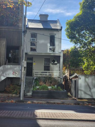

My old garden bed retention walls are rotten. it's heavy sleeper wood.
It's too heavy. Bunning promotes plastic retention wall. How to use it?
