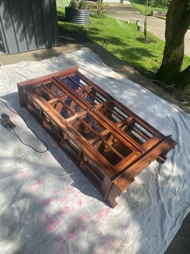

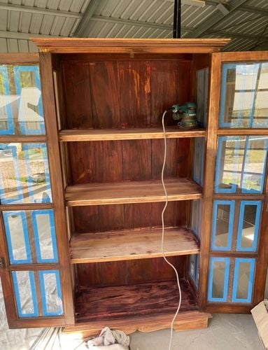

First I cleaned the entire piece and taped every window with Scotch Painters Tape to avoid them being scratched when sanding and in preparation for the eventual paint wash.
Step 2
Next I used a paint stripper in an attempt to remove the cherry wood stain. This was only partially successful so MANY HOURS of sanding followed. I did all the larger, flatter surfaces with the orbital sander, then used the detail sander for the more difficult parts. The carbine scraper was used to remove the old stain from the profile ridges around all the windows (384 in total!). I used a credit card wrapped in sandpaper to hand sand each of these.

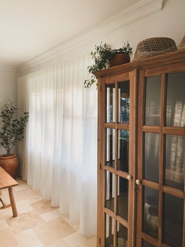

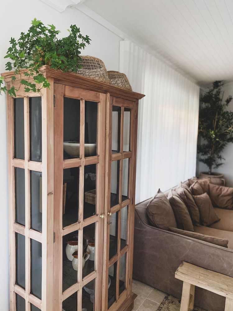

Once the entire piece was sanded, I applied the tan paint wash using 1 part Dulux ‘Earth Kiss’ to 9 parts water. I left the wash on for approximately 1 minute before wiping off with a clean cloth.
I repeated this twice on the exterior and interior of the doors (not shelves).
I then followed with 2 coats of Cabot’s Water Based Walnut Stain - again watered down 1 part stain to 3 parts water.
Step 4
I finished with painting the interior in Dulux ‘Hog Bristle’ to create depth, contrast and warmth. I used the UniPro ‘little ripper’ rollers to do 3 coats of this.
Step 5
The final step involved cleaning and updating the hardware. I used steel wool and bicarb soda to bring the hinges, lock and key back to life. I removed the handles and replaced them with 2 brushed brass door pulls from Bunnings.
Step 6
A Bunnings trailing Ivy plant and Teracotta pot completed the styling on top, with some wicker baskets to create texture.
