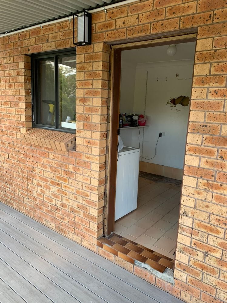

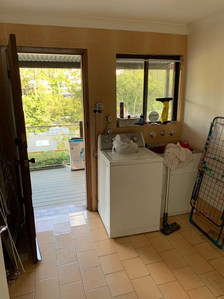

Looking outside into LaundryThe DIY project was the full modernisation of the original laundry Installed some 44 years ago. It was outdated and reflected a poor utilisation of space. The Laundry was out of the 80's. The goal was to be effective, modern whilst connecting to the outdoors as this is a main thorough fare.
This included the complete removal of the back wall, gyprock, new sliding internal and external doors, new storage cupboards alongside new shower and toilet in adjoining room. Tiling of all wet areas opening up the entrance onto the back deck improving access and increasing the property value. A huge success.

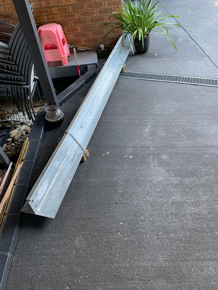

Timber 2400mm lintel

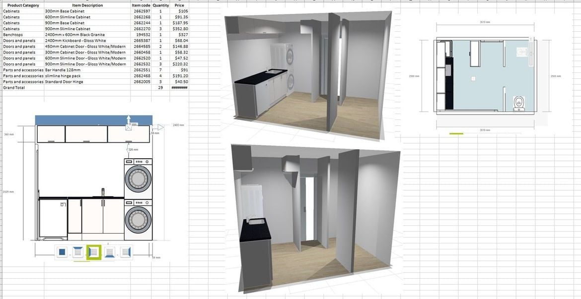

Using the Bunnings https://planner.kaboodle.com.au/ I found the planner a great visual aid and very easy to use including a 3D view. This step provided diagram for the engineer to review and a full bill of materials with an initial estimate.

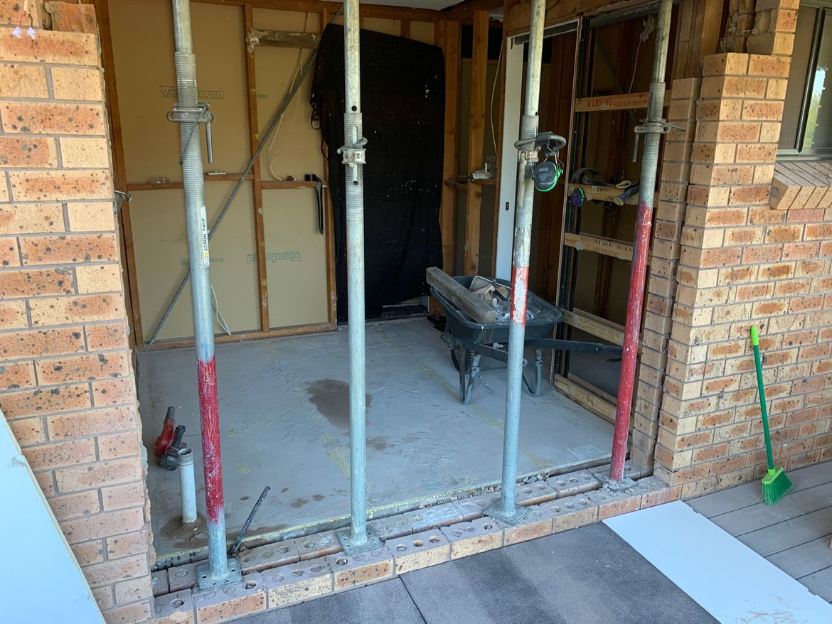

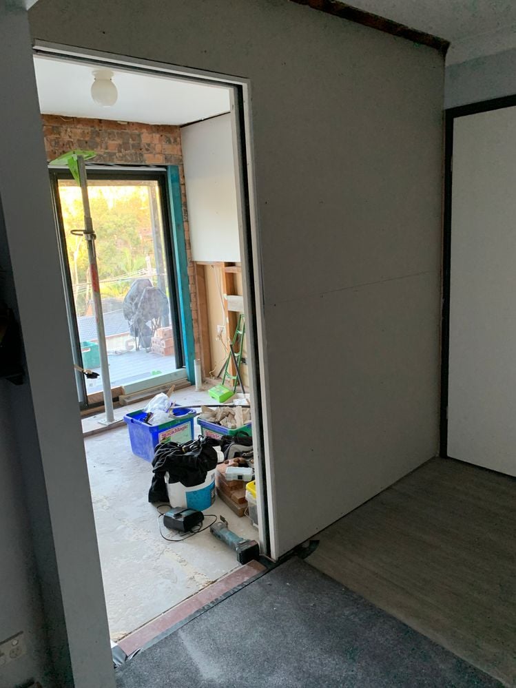

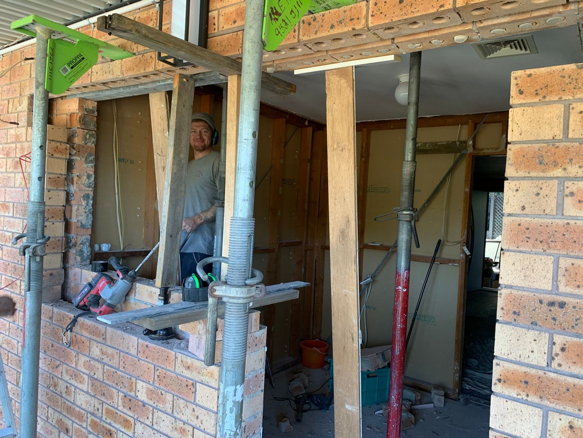

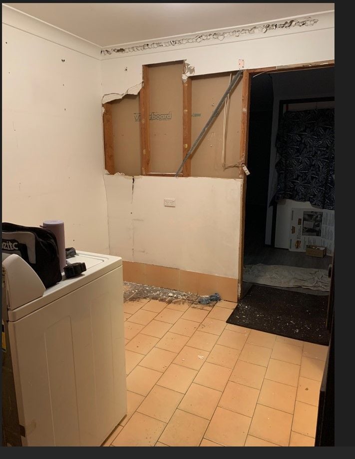

After planning and estimation demolition began
Step 3

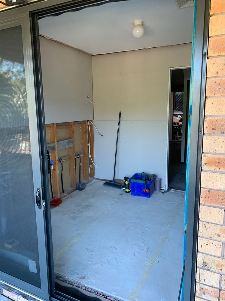

After demolition the following tasks were completed:

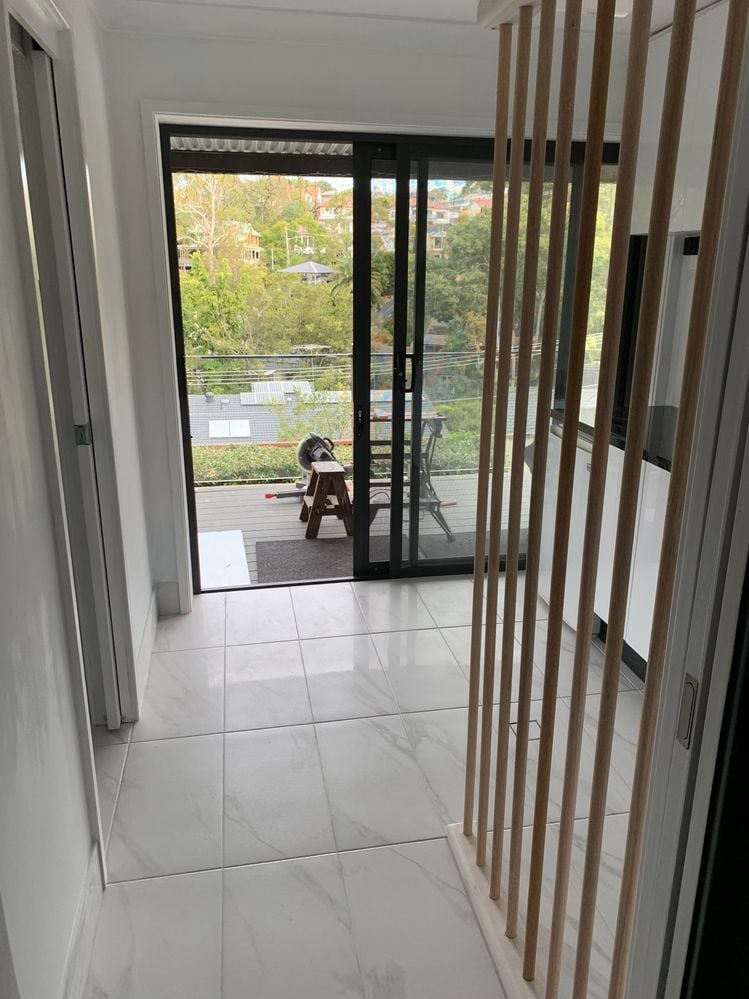

Supports for both sliding doors
Electrical work
Plumbing
Install both doors frames
Timber noggin supports for the on the wall dryer to be hung, top storage cupboards and inside wall tap fittings.

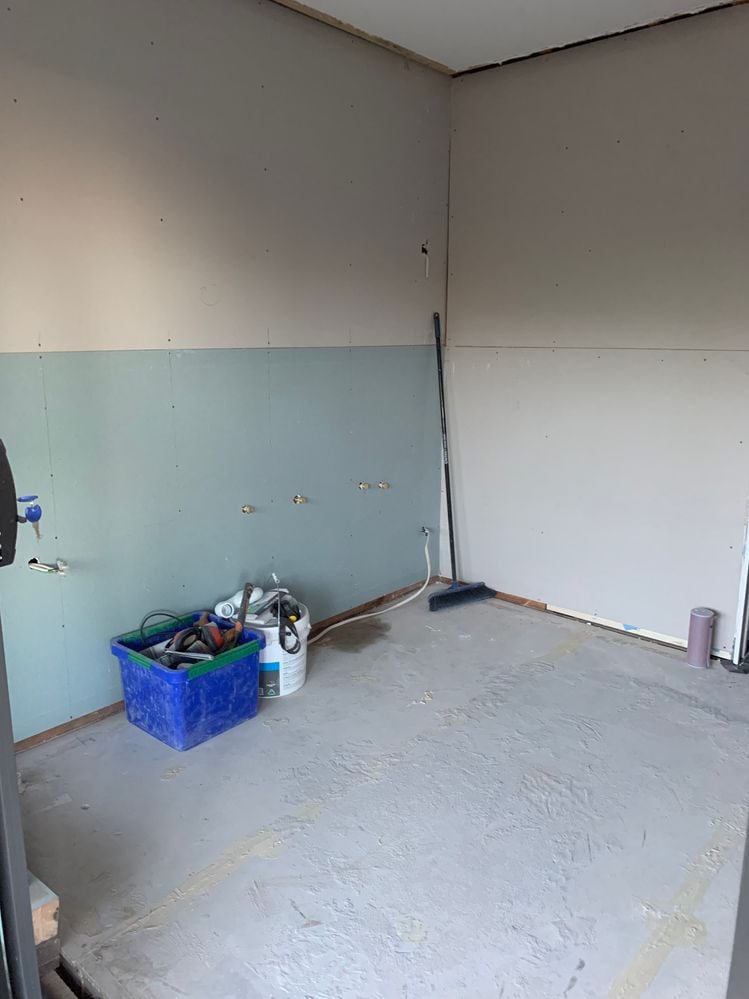

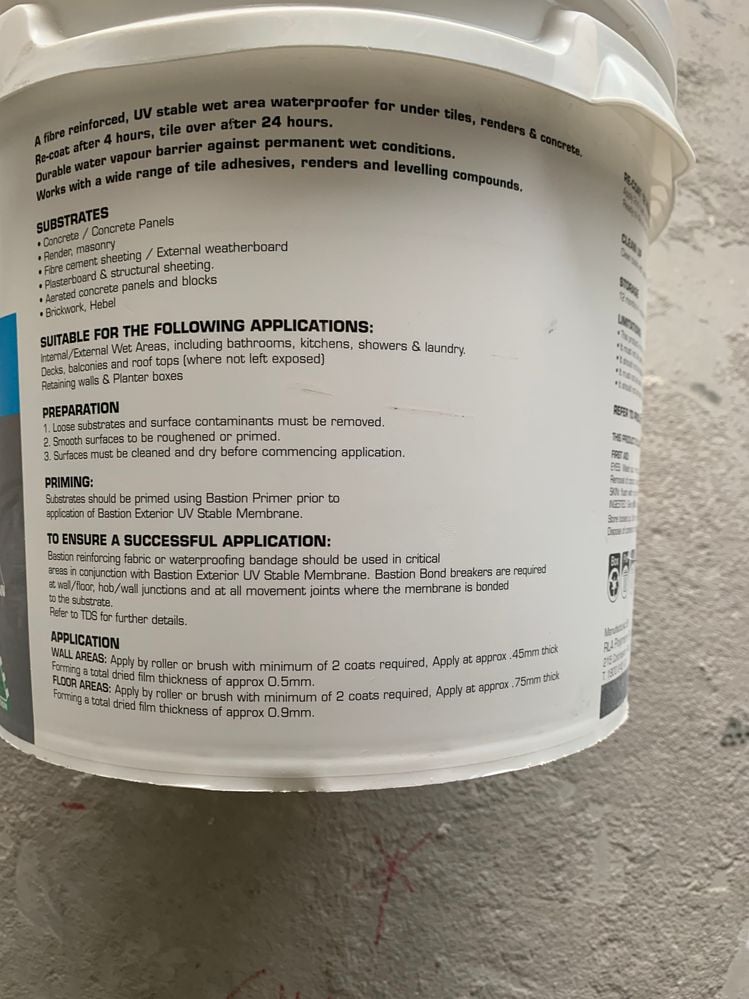

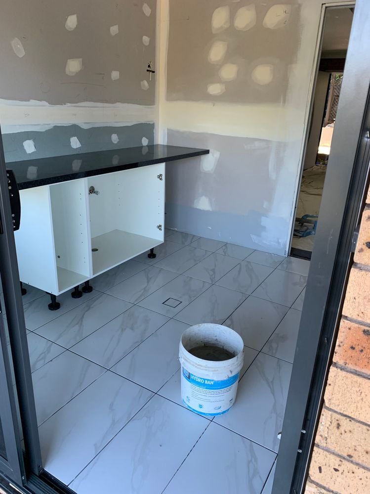

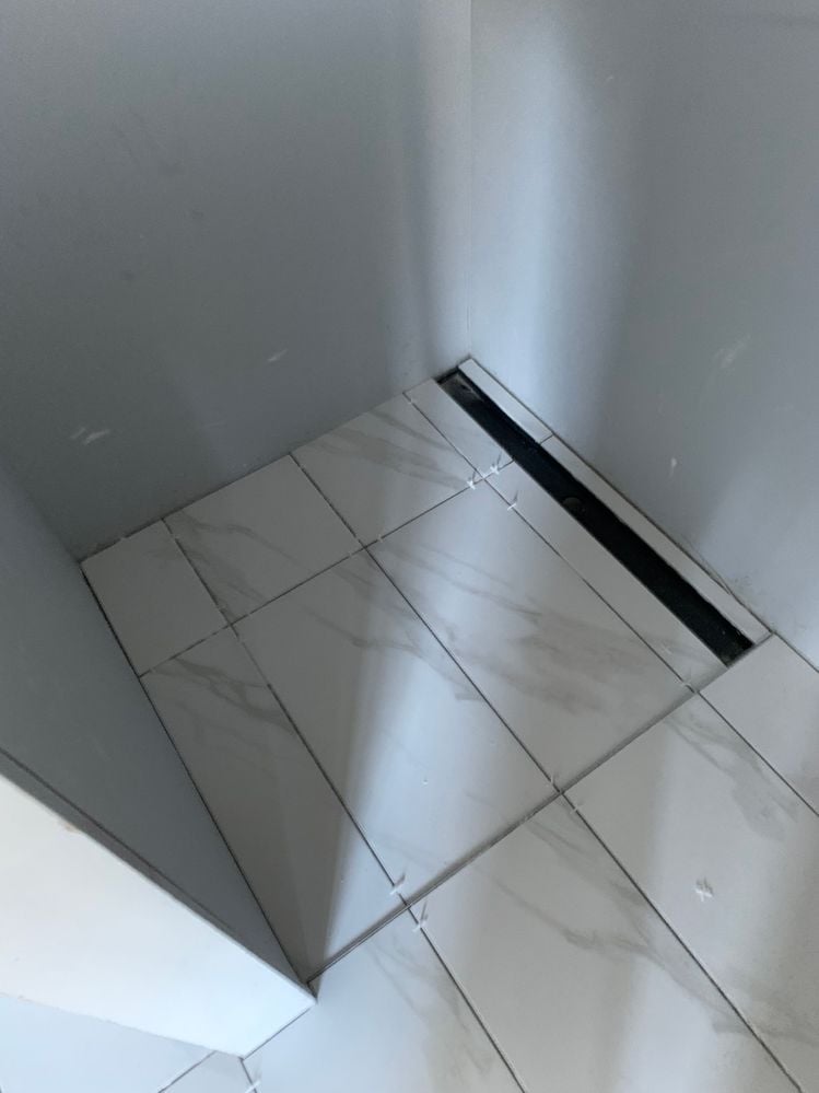

The right gyprock was installed for dry and wet areas followed by several applications of water proofing purchased from Bunnings.
Step 6

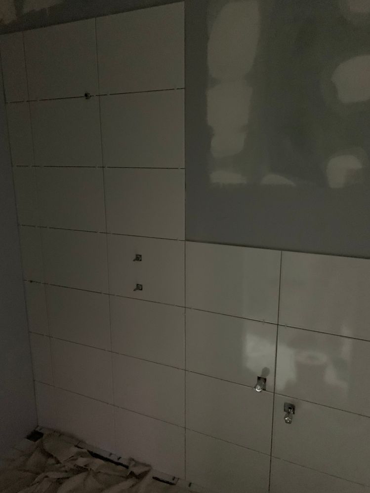

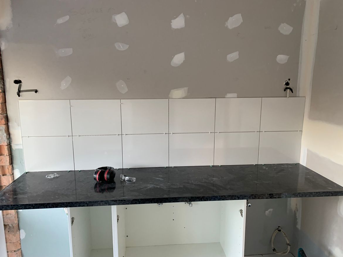

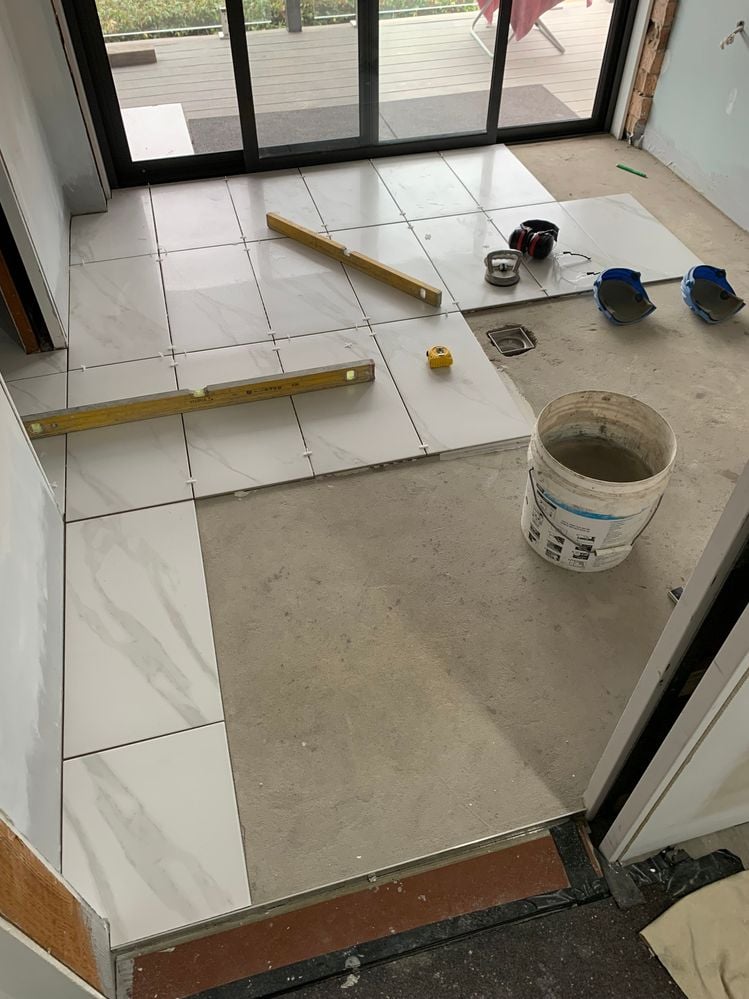

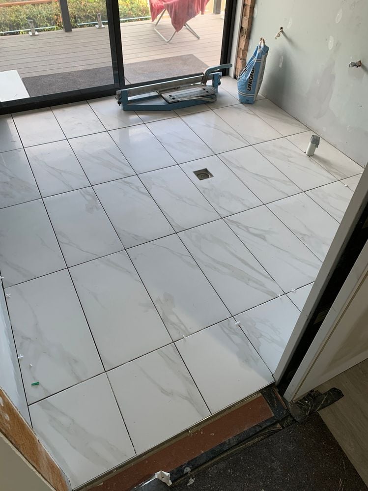

Next came the tiler who laid the cement screed, let that sit for several days then began tiling walls and floor
Tiling using Kaboodle plans
Step 7

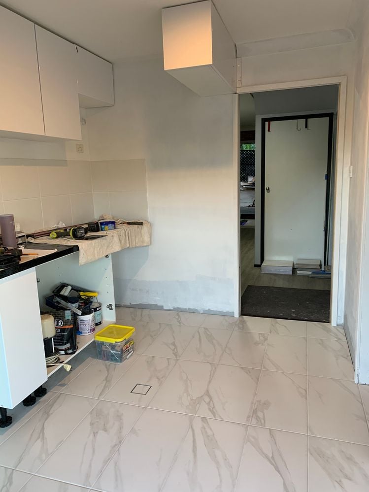

Begin to install Kaboodle floor cupboards and bench so that wall tiling can commence in all areas.
Step 8
After tiling the following tasks were actioned and completed.

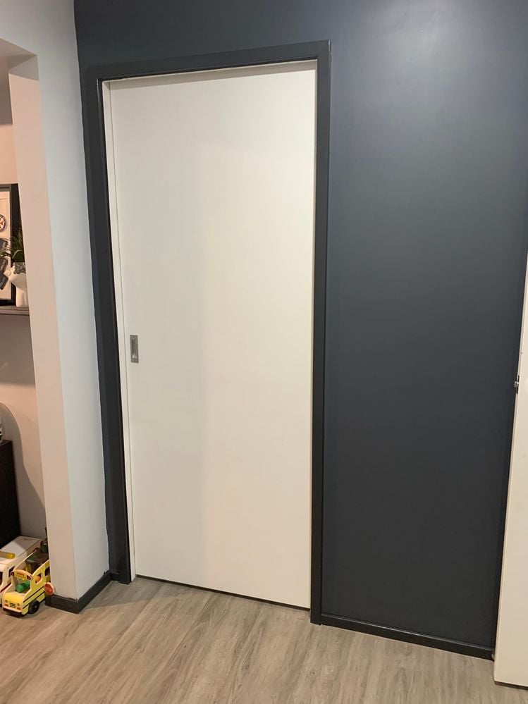

Painting & cupboard doors installed.

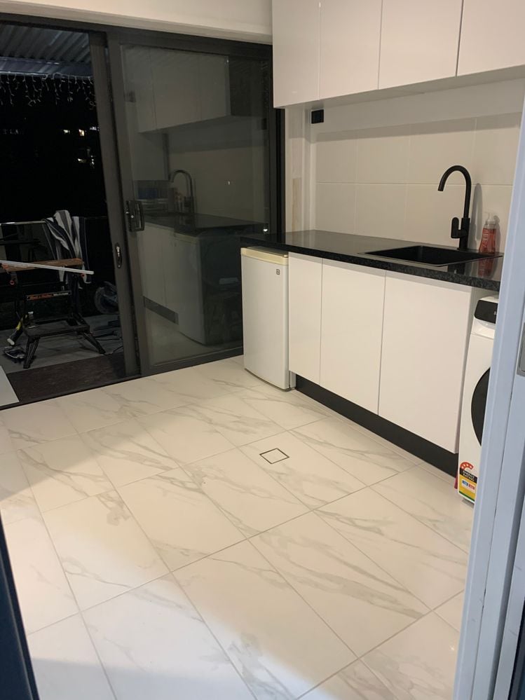

Then all the finishing items installed,
Taps

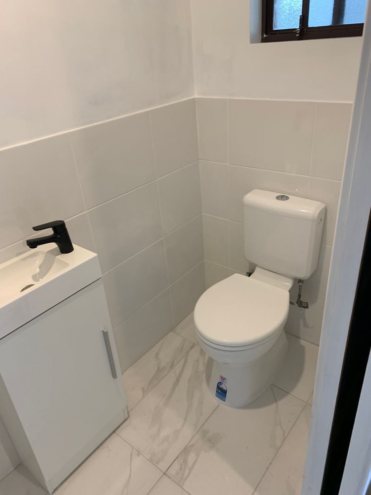

Toilet
Vanity
Shower taps and head
Sinks taps
Towel racks and mirrors

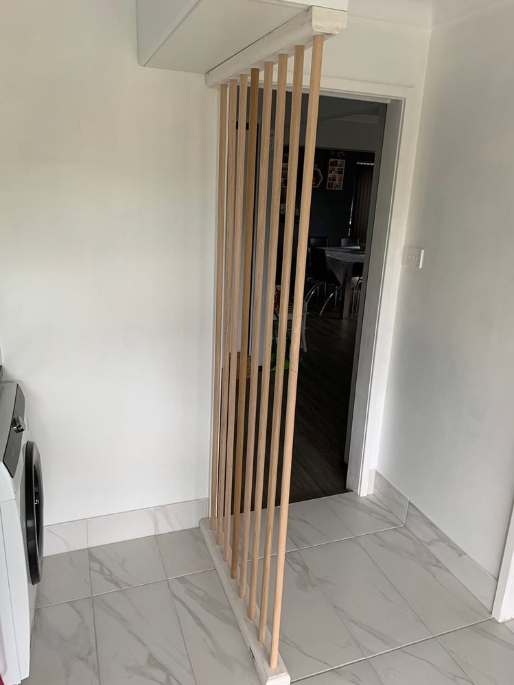

Step 10

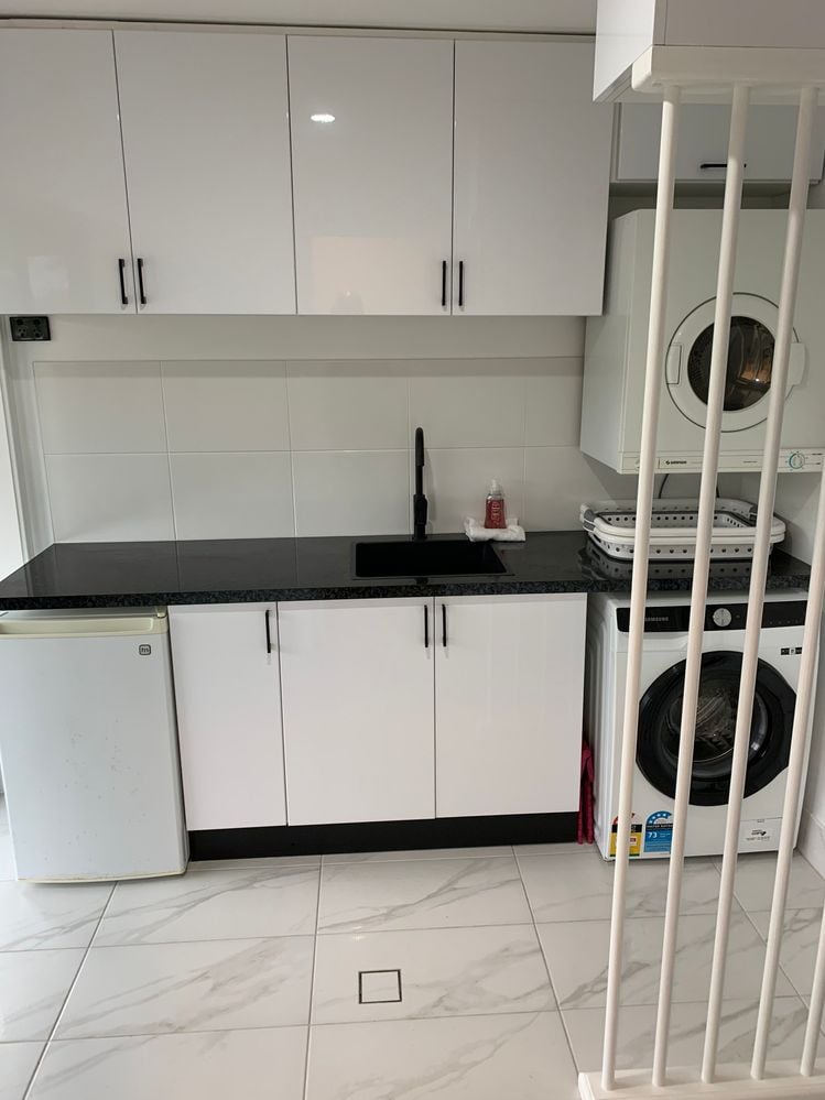

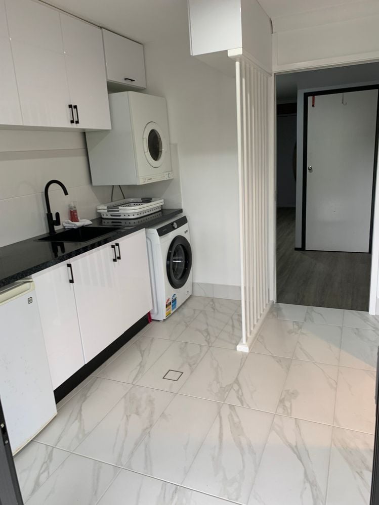

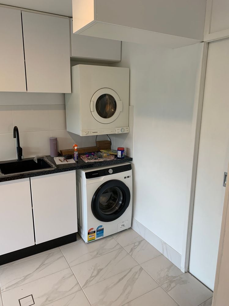

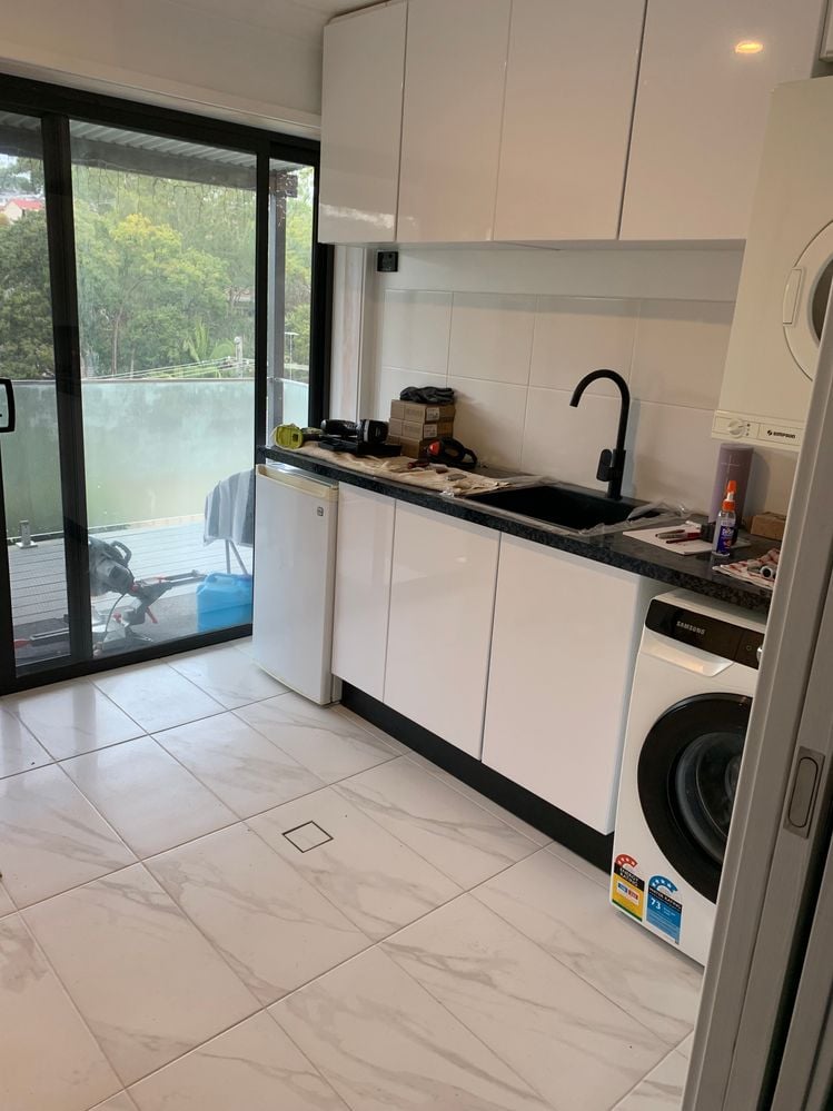

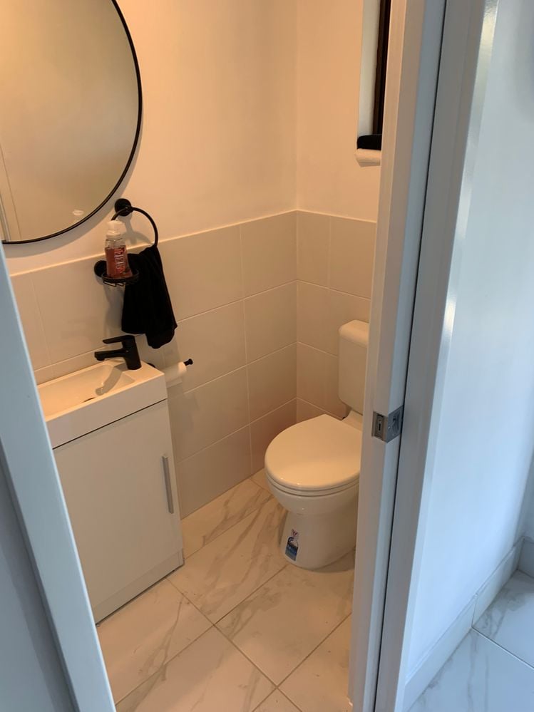

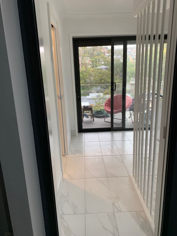

Before and after plus Enjoyment
Finally enjoyment
