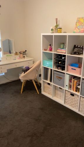

Before :

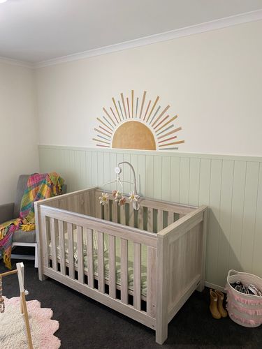

After :

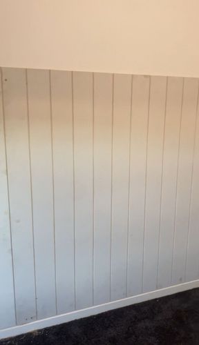

Step 1

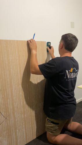

Firstly we cut our panels to a height of 1.2m and then located the studs in the wall.
Step 2

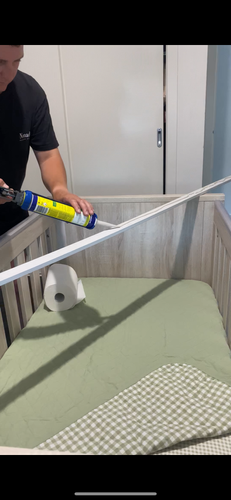

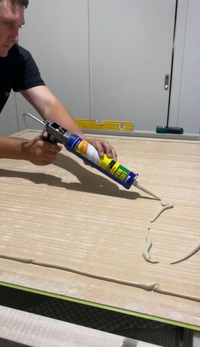

We used liquid nails and screws to secure the panel to the wall making sure to screw into the wall studs.
Step 3
We then filled all the screws holes and placed a boarder along the top to finish it off neatly.

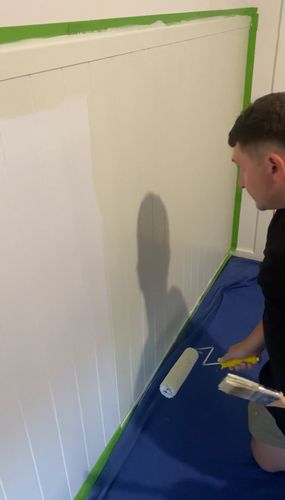

Step 4

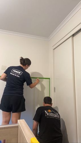

We used British Paints spearmint crush 399 for the colour. We primed the wall with paint primer and then did two coats of colour.
Step 5
To finish it off we added a wall decal we found in the paint section. (I can’t find the link to it).
