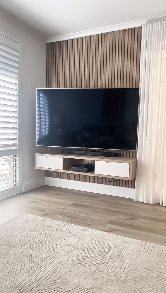

We fed all of the electrical wires through the hidden trunking first, as experience told us that this gets tricky if you have furniture and big TVs in the way!
Tip: If you aren't sure of which wire goes into what device, you can label them with a small piece of masking tape at one end.
The new wall-mounted TV unit was installed and the TV bracket re-attached to the wall and the feature wall was complete!
