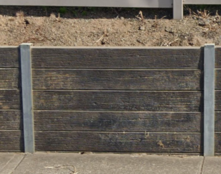

I have no idea what this fencing is called and I have researched but no lucl unfortantly finding the name, I have seen this used in gardens as small beds.
Can anyone kindly tell me?
Many thanks

Welcome to the Bunnings Workshop community. It's sensational to have you join us, and thanks for sharing your question about the garden bed fence.
The product you are referring to are called sleepers and they come in timber, concrete and composite material. The sizes range from 1.5 to 2.4 meters and are generally 200mm in height and 50mm thick. The product on your photo closely resembles the Ridgi 150 x 50mm 1.5m Ironbark Reinforced Concrete Sleeper.
The posts appear to be the galvanised sleeper posts. If you wish to have a better look, I suggest visiting your local store and proceed to the outdoor timber area and have a look at the sleepers available.
