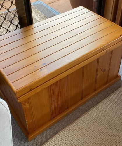

hi all, i want to put castors on a blanket box. It will need to carry at most 300kg load and will be used on vinyl plank flooring. Which of your castors would you suggest.

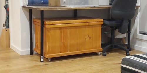

Hi Eric,
Thanks for that. I decided that i will not allow anyone to sit on it, which brought the weight limits down to an estimated max of 120kg. I have gone with the Easyroll 50mm 40kg Load Transparent Swivel Plate And Brake Castor. I decided to try these and swap out if needed later. Smooth as, and very light touch to move it even with a load in it. Doesn't seem to mark the floor at all so I'm hopeful. Will post again, and look at replacing with the 100kg rubber ones you mention, if i find these don't work.
