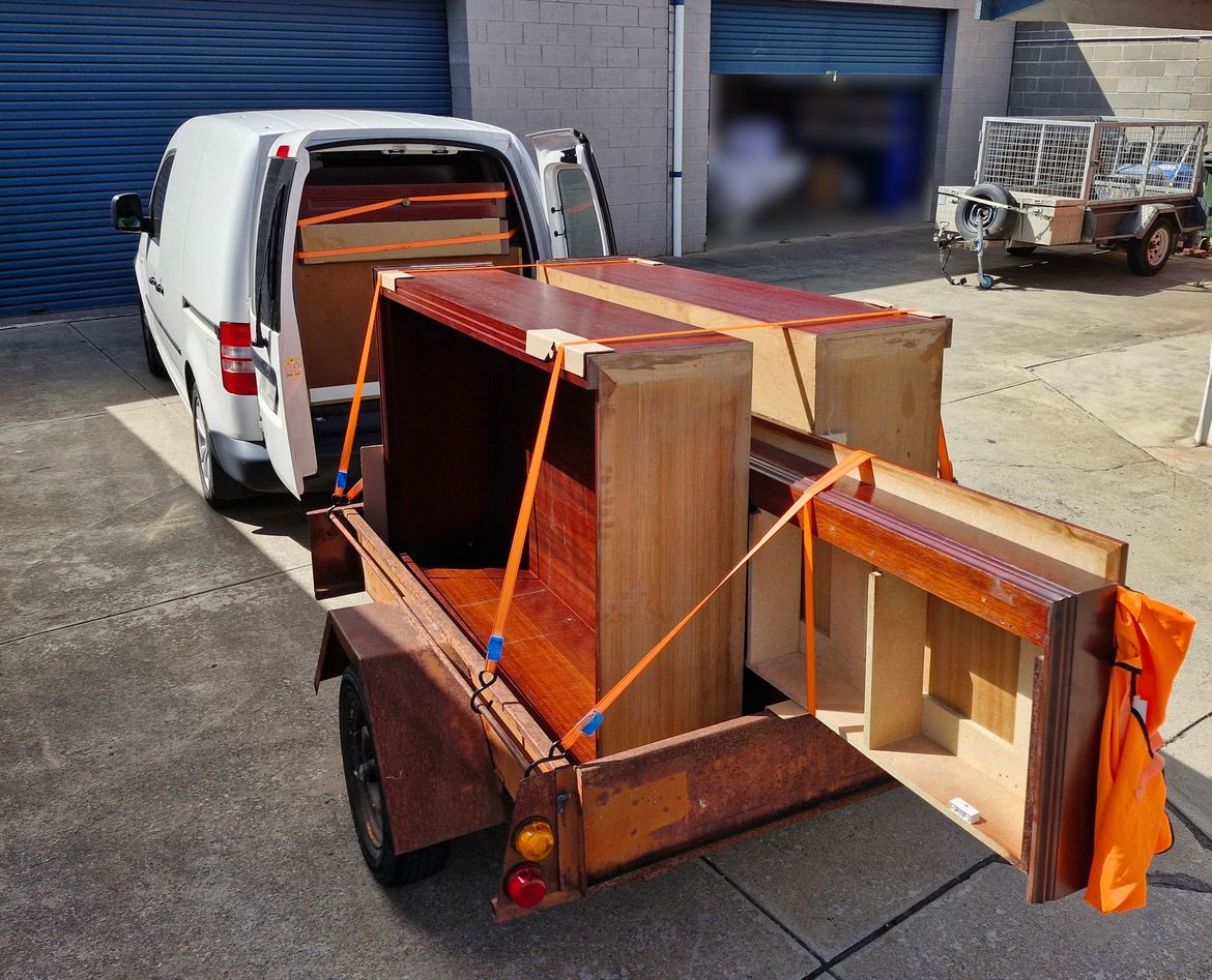

1. Disassemble and Transport
I bought this old bookcase used on marketplace and had to disassemble it in order to transport it. Remember to group up the hardware and screws as you take them out. Separate the screws into labelled zip-lock bags as you go so you know where they are used when you reassemble it. Label the inside of the cabinet doors, drawers, and shelves.

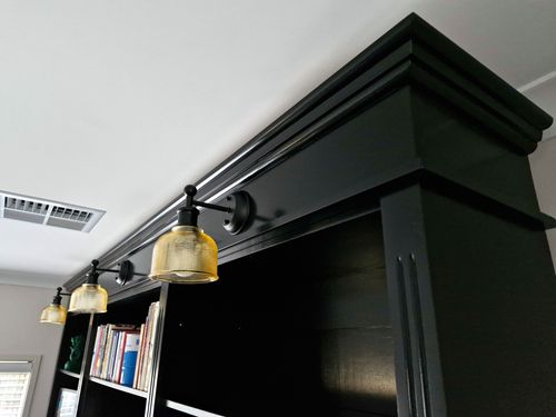

Top Crown:
This bookcase must have originally had a crown as there are glue marks and screw holes on top where it would have been. To make a new crown I did not want to do any custom routing. Instead, I stacked the following primed MDF mouldings already available at Bunnings to make it look like a cornice profile. This was also cheaper than buying proper timber cornice.
Primed MDF mouldings cut and stacked from top to bottom:
- 67x18mm bullnose
- 67x18mm bevel
- 67x18mm bullnose
- 140x18mm rectangle (upright)
- 92x18mm rectangle

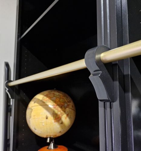

Library Ladder and Rail:
- The library ladder I purchased complete.
- The ladder rails are brass plated curtain rods. Much cheaper than real brass tube.

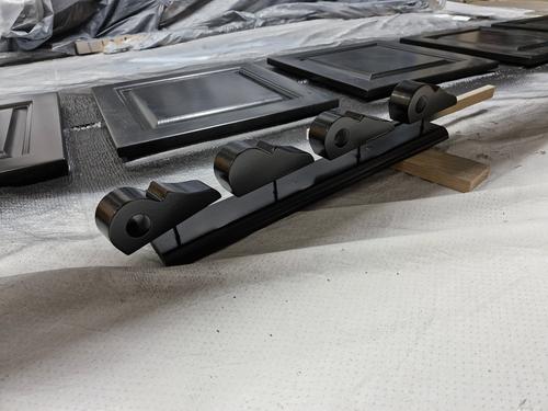

- I made brackets to mount the rail from MDF offcuts. I routed them to match the provincial style of the bookcase.

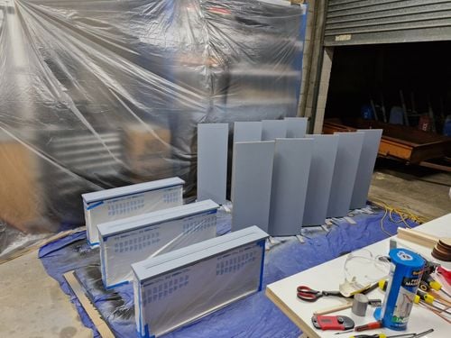

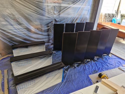

Step 4

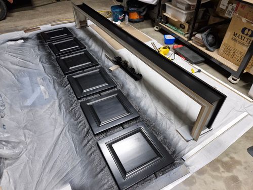

4. Painting
I used the Wagner Flexio 590 HVLP sprayer for all painting. It’s much faster and easier than brushing or rolling when painting large areas or many pieces such as this bookcase.
PRIME: 2x coats of Porters prepare and prime. This Porters primer is really creamy and fills small gaps well. It is also a stain blocker if your furniture has oil-based stain.
PAINT: 3x coats of Porters aqua gloss enamel aniseed black. Gloss black is notoriously very difficult to achieve a good finish with rollers or brushes. This is where the HVLP paint sprayer is a must.
Due to the number of pieces to be painted and limited space to work, I painted several pieces at a time, let them dry for one week, then moved them into my office to assemble. Starting from the base cabinets and working up to minimise extra handling.

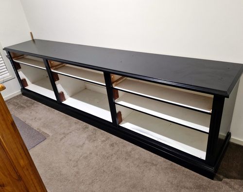

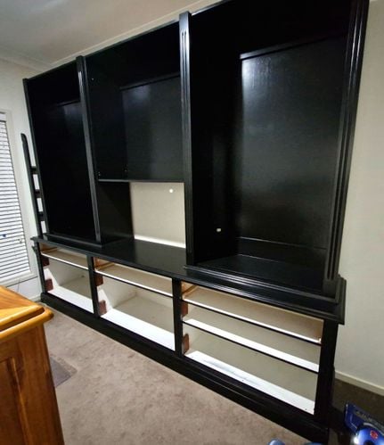

Step 5

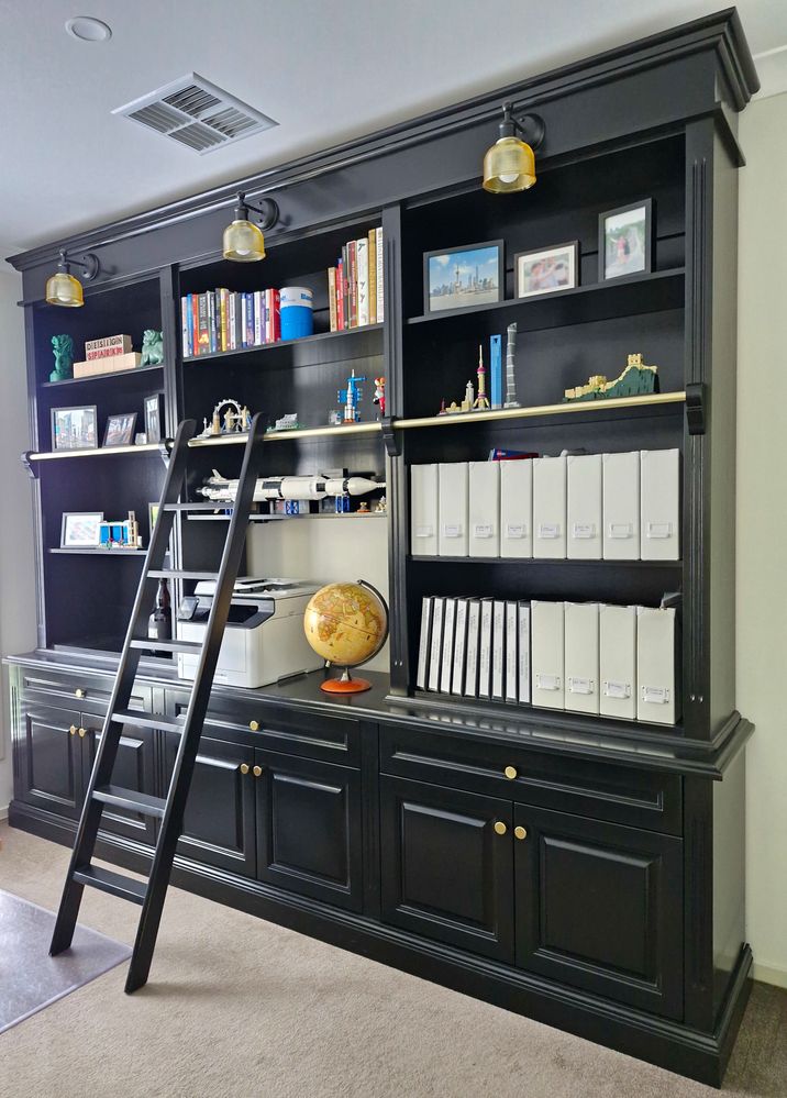

5. Assembly

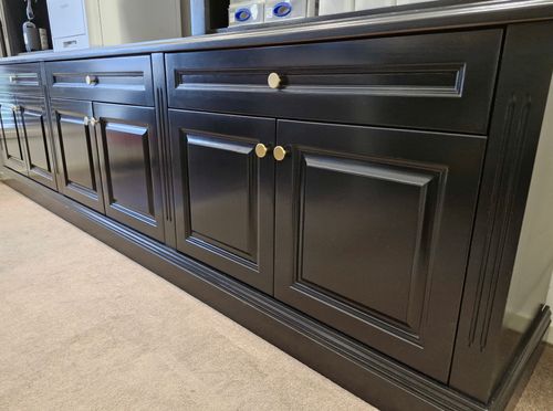

Build up bookcase from the base cabinets up. The base is so long it didn't fit diagonally through the door to the room so I had to take out the front window of the house to get it in. Installed the light fittings in the crown. Installed modern style brass drawer handles. Changed the original brown shelf supports to black.

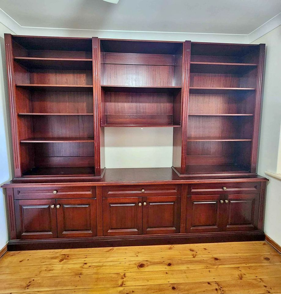

Step 6
Before / After Comparison
