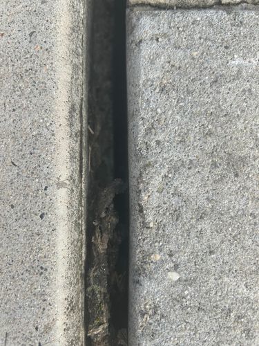

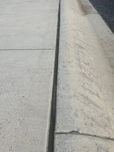

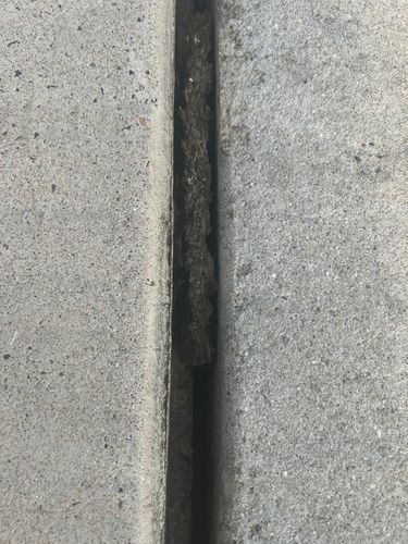

Hi mate, please see attached images. It’s basically just where the initial foam was when the original slab was laid.
Thanks for the images, that gives me a much better idea of what we're working with.
It looks like they may have used an expanding foam in the first place, which like I said, is not UV resistant. This is why it will have degraded over time.
I'd suggest removing what is in the crack, replacing with some Abelflex in a suitable width and applying the Sika 11FC over the top to create a flexible expansion joint like you will see in concrete construction all over the world.
