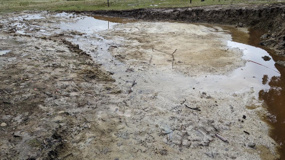

I inherited a bush block in S Tassie with a cleared area (7m x 18m),where one par,t 7m x 8m been taken back to clay. It is fairly level. At the back of this level site is a ditch about 500mm wide and 500 deep that runs the 18m that the previous owner was going to turn into a French drain. The reason is that beside the open area where I want to put the container is an old steel shed on a pretty bad concrete slab. The run off from the hill behind was entering the shed. I intend to use the shed to put larger things in (e.g. car).
I want to put a container on the site to store tools and so on and use as a shelter. Ultimately, say in five or so years, the container would be removed (and likely the shed too).
My question: What base should I put the container on? Advice has ranged from:
just put it on the clay;
plonk it on a couple of sleepers;
use some concrete blocks
pour a slab;
I would prefer to use as little concrete as possible, but would use the DEKO blocks. My concern is the clay.
I'm thinking of a boxed base, with compacted crushed coarse stone, rather than road base. Perhaps I'm over thinking it or on the wrong foot entirely.
I would be very grateful for any advice and suggestions. I can get access to a compactor and have all the usual tools.
