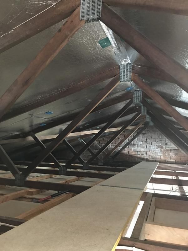

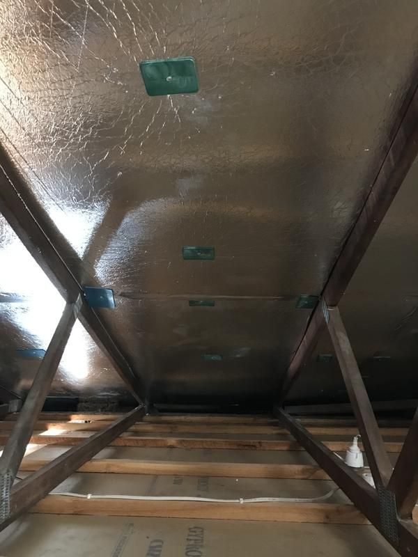

Using Foilboard is a great way to insulate your tiled roof, the only other product that comes to mind is Ametalin 1500mm x 20m ThermalLiner Roof and Wall Shed Insulation. Both products provide insulation, but I believe that Foilboard is easier to install.
Here is a handy step-by-step guide: Foilboard Roof Insulation

I have similar sort of roof in my 1960s house with terracotta tiles and i was wondering would sarking/foilboard fitted in the way shown in the pictures above lead to mould or mildew problems due to moisture not being able to escape and insufficient air flow to the attic?
Hello @happycoconut29
Welcome to the Bunnings Workshop community. It's sensational to have you join us, and thank you for sharing your questions regarding moisture entrapment in the roof cavity.
I agree with your concerns regarding moisture getting trapped in the roof cavity. I therefore suggest installing a Whirlybird/Natural roof vent to provide air circulation in your roof cavity. You can combine it with a Haron International 150mm Round Jet Diffuser Ceiling Vent to circulate air in your laundry and other parts of your house. They can be closed during wintertime and re-opened during summer.
