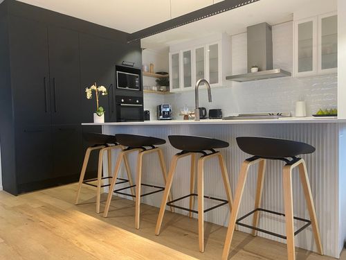

I bought a lovely house but it was in serious need of updating. Newly single woman, I was nervous to go it alone but I was inspired after shopping at Bunnings and a year later I can’t believe what I have achieved. This is just one project I was able to achieve with very little skill but a big imagination!

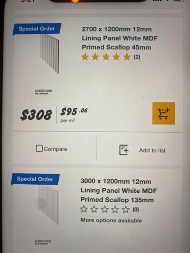

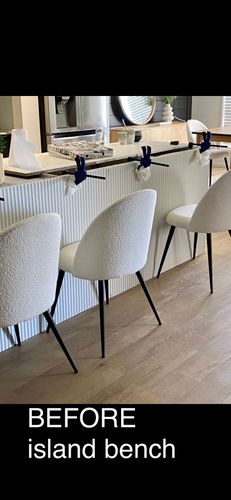

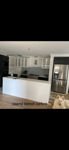

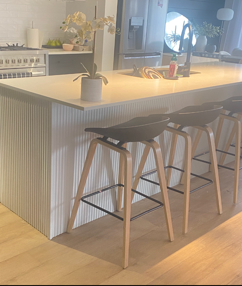

After putting together my kaboodle kitchen, I needed something special for the old island bench I decided to keep. I found some panelling at Bunnings

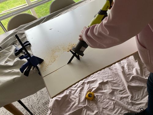

I purchased a reciprocating saw and used my kitchen table as my work bench to cut panel to size

I then used a construction glue (heavy duty liquid nails or silicone works) to adhere panel to the old laminate island panels, and secured it with clamps, applied pressure and left to dry

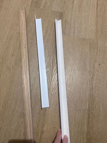

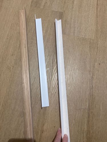

I found some options at Bunnings to finish off the corners where the panels join

Next painting! I am about to go into Bunnings and find the best paint to finish off the job. I love the look
