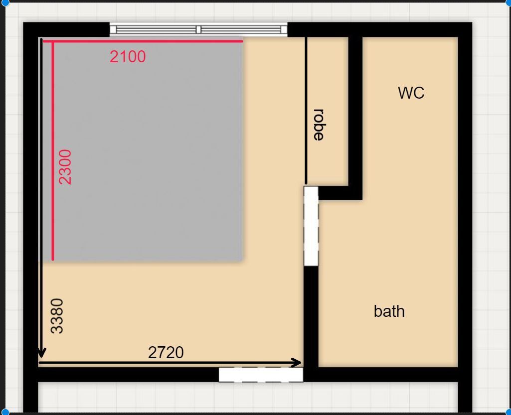

The pictures above depict my small bedroom in my small one-bed flat and a table-height platform I would like to build to create more storage and a bit of visual interest. I want it to feel more like a raised bedroom than a loft bed, so my current bed would sit atop the platform. Sort of like this:
In time I will devise steps for the top right and bottom left of the platform, so it can be accessed from two sides by two people -- but that's a project for another day. Right now, my priority is getting it built, properly, and using the storage space below.
I want the top of the structure, sans flooring, to be 730mm high. (With subfloor and eventually finished flooring, I anticipate the top of the platform being 760mm high). This allows me to comfortably stand on the platform without hitting my head and it won't obstruct the window.

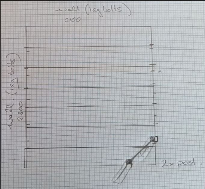

Now my main questions relate to the type and spacing of lag bolts and post(s) and timber sizes.

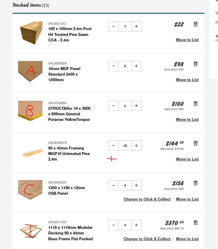

From the modular decking panel (I) in the shopping list below, I determined that given the height of my platform 90 x45mm timber would be adequate for the frame. Is this a fair assumption? I was seriously considering using these for my project, not least of all because I could fit four of them in my car, but the measurements aren't quite right and it'd cost my about four times as much.
I know I'll need 100mm lag bolts for the two beams (bearers? I get confused sometimes!) to be attached to my brick walls, but I'm not sure how many or how best to lay them out. Can anyone help me figure this bit out please?
To make things a little trickier for myself, I would like to curve the bottom right corner of the platform. That's why I have tentatively drawn two posts connected by a diagonal piece of 90 x 45mm timber. I would create the curve by slightly cantilevering the flooring. Would that work?
Also, should I consider putting perpendicular supports between my joists? Or would I be overengineering by an unacceptable degree?
Finally, should I be using joist hangers or could I get away with a hole jig and screws? If the latter, what type, strength and length (and angle) of screws should I be using. I get the impression 'decking screws' are more for connecting floors to joists as opposed to securing the joists to the outer frame, but I may well be labouring under a misapprehension there.
Finally, my shopping list below includes a few items (A,C + I) that I no longer intend to use for this project but which helped me get to this stage in my planning. I think I will add another two 2.4m lengths of the 90 x 45mm, to allow for errors and/or create joist supports if advised, and obviously need to add all the screws, hangers and other hardware I might need.
