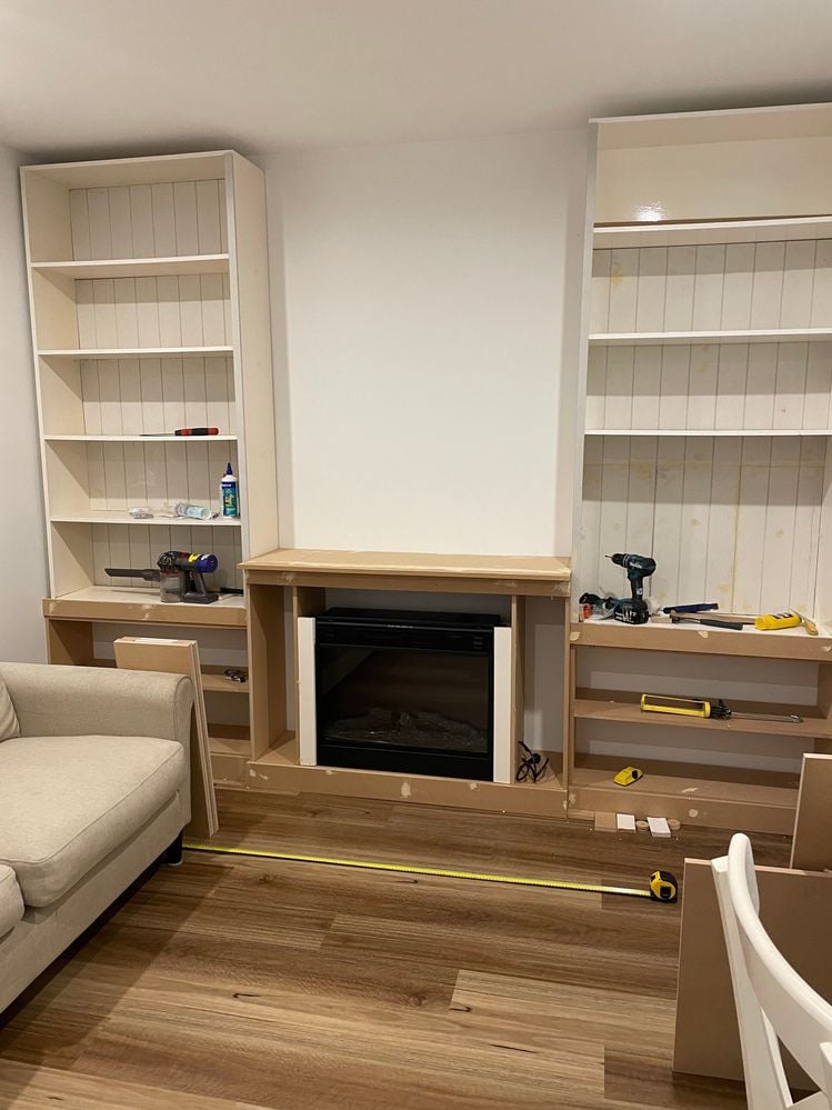

Measure the space available for the built in unit. Consult Fireplace insert manual for minimum clearances and measure bookcases. Using these details, make up a draft plan of the project to suit your space and needs. Box out a simple fireplace surround by cutting MDF pieces to size using circular saw (or bunning in store cutting service), and glueing then screwing edges together into a rectangle. Secure your fireplace inside and double check safety clearance according to fireplace manual. Screw a backing piece along the top inside edge of the box to provide a surface to secure the unit to the wall.
Create 2 additional boxes the same way to fit either side of fireplace (add shelves if desired). Consider how your fireplace will reach a power point and use a hole saw attachment to drill access through units if needed.
Build a short rectangle using scrap wood to place flat on the ground as toe kick area, then secure boxes on top. Secure boxes to the wall by screwing through the backing piece using screws that will suit your house framing.
Cut bookcases to fit remaining space, line with VJ boards if desired, lift into position and secure to the wall. Cover your toe kick area and joins between the new unit/old bookcases with a nicer piece of MDF cut to size.

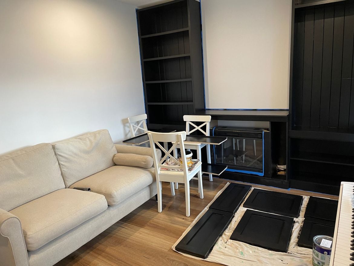

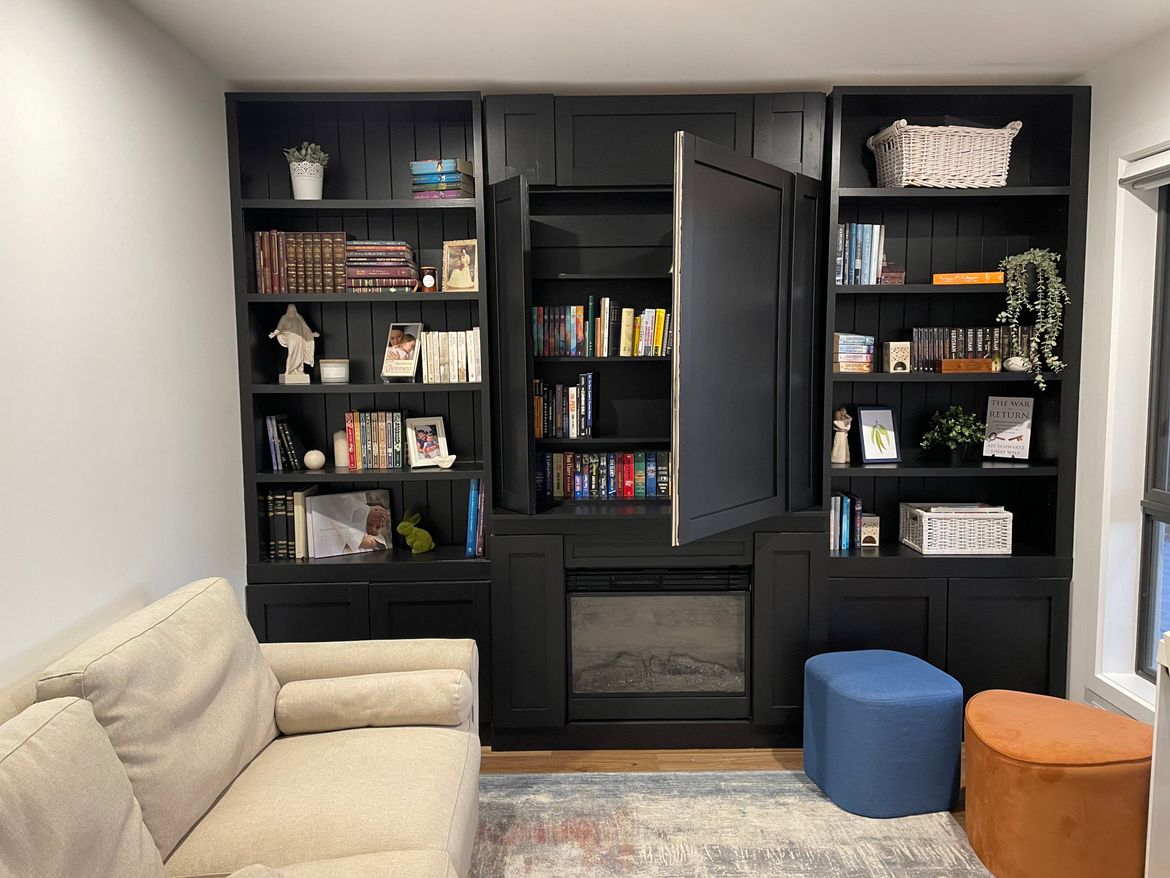

Once paint has dried, mount the doors to unit using hinges and run the fireplace's power cord to the power point. At this stage I decided to add additional shelving above the fireplace by screwing rectangles of MDF into the bookcases either side. I then enclosed this area with doors made from several rectangular pieces of 6mm MDF (on which I repeated the decorative Hamptons styled trim), to provide additional hidden storage

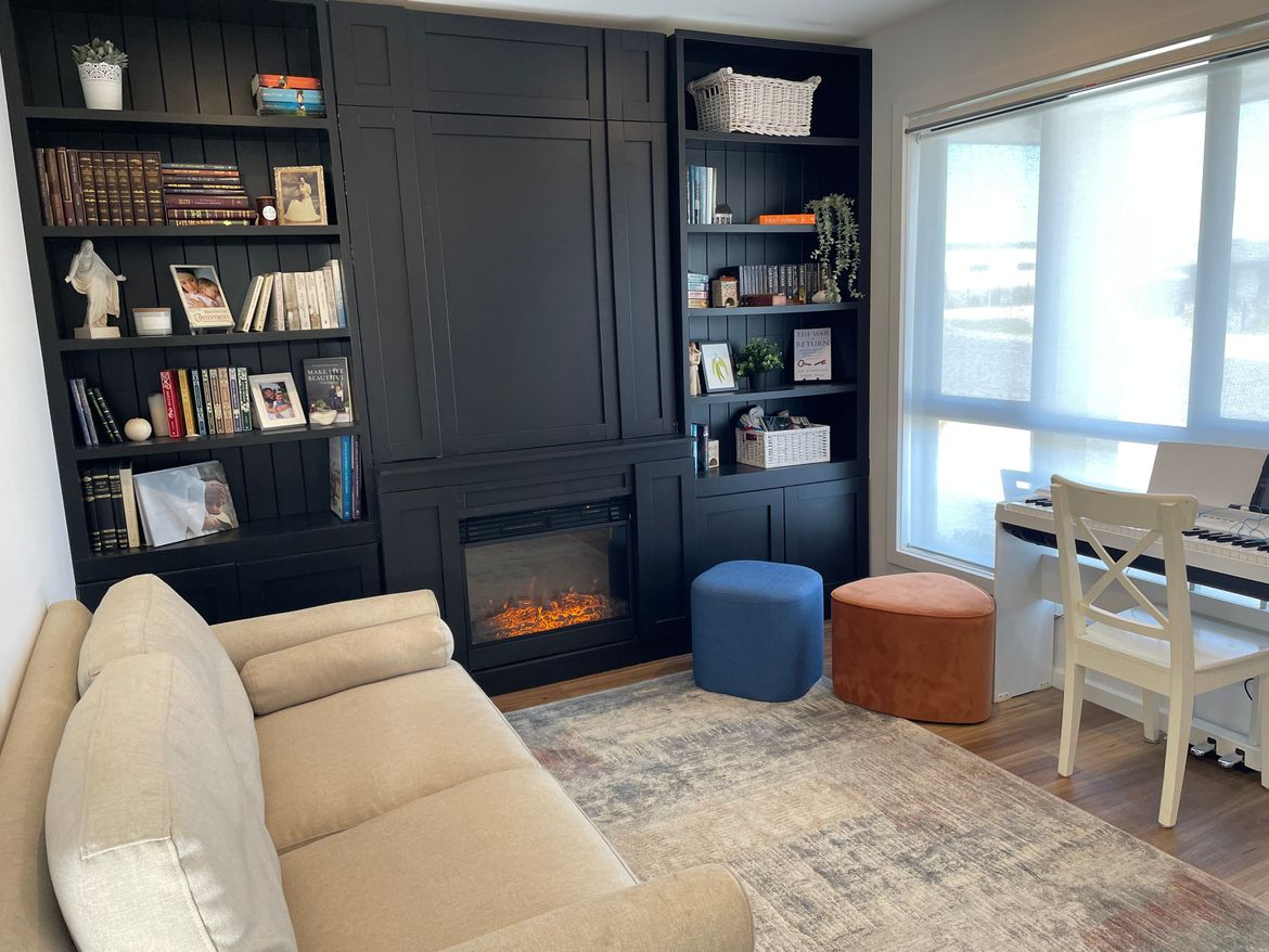

Flick on the power, and enjoy your new cozy winter wonderland!
