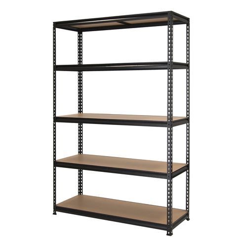

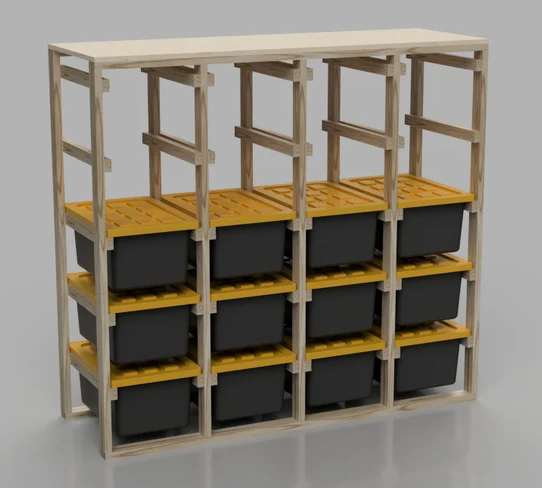

I'm hoping to build a storage rack like the one below. Can anyone help me out with what wood to use.
Doesn't need to be pretty just want to use what will be the most economical option for the job

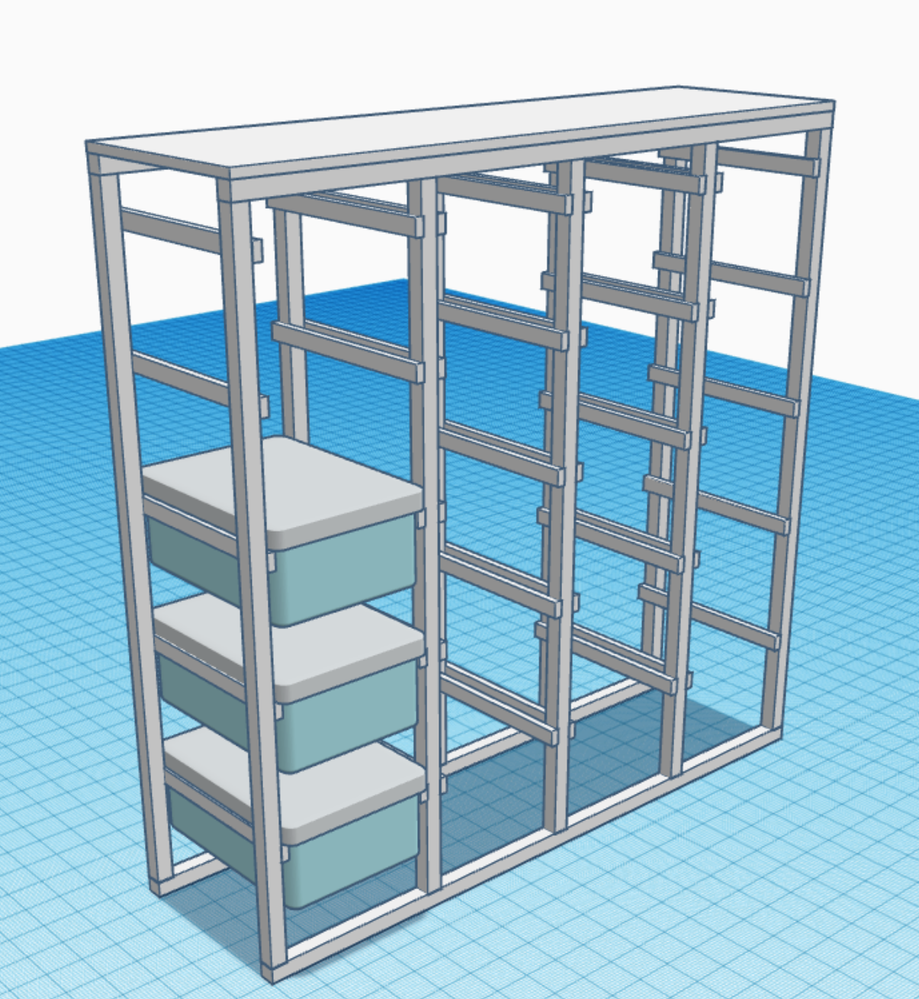

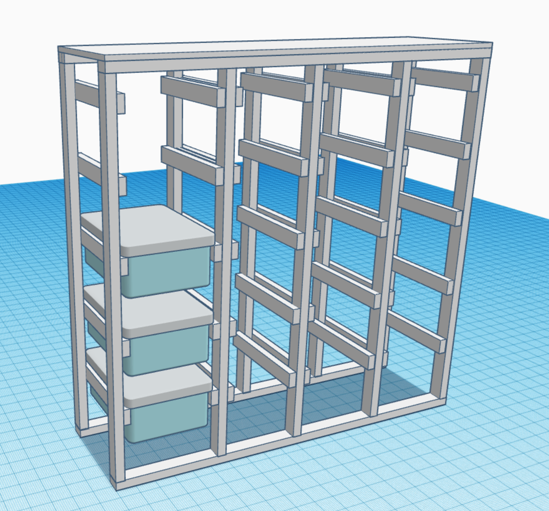

I'd suggest that using 42 x 42mm 5.4m Baluster Handrail H3 Pink Pine FJ Primed LOSP for the frame and 42 x 18mm 5.4m Moulding H3 Treated Pine FJ Primed 4 Edge Pencil Round LOSP for the rails would work well. Those timbers are reasonably budget-friendly. However, you could almost half the cost if you created the whole thing from 70 x 35mm Framing MGP10 H2 Blue Pine 5.4m.
I've created renderings of both versions below for your viewing pleasure.

As the design is based on the width and depth of a container, @MitchellMc has left things ambiguous as an example of a design, rather than a specific plan.
We would need to know the dimensions of the specific container you're using to assist with a design. If you can let me know what size containers you are looking to use, I would be happy to assist.
