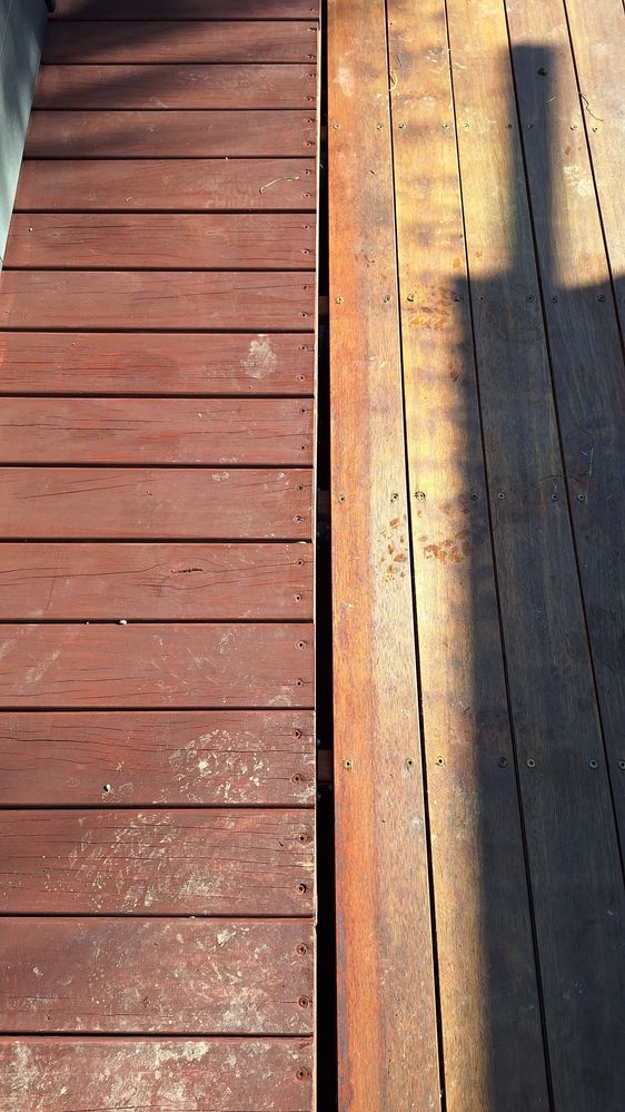

There was a 1cm gap between the spa cedar deck and the Kwila deck that runs parallel to the cedar deck. The gap came about because i preferred to keep the full lengths of Kwila at the front(so it looks good) and have the odd gap at the back. The challenge was to close this gap. Cutting a piece of kwila and then trying to ram it into the space was not an option. Using aluminium to close the gap was the best option.

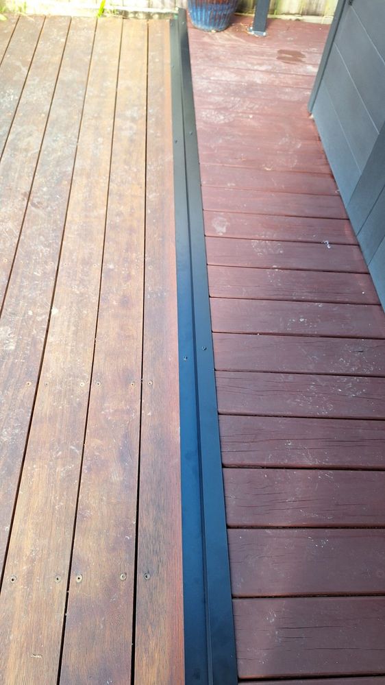

Step 1
Cut L shaped powder coated aluminium to size
Primer painted cut edge. Finished edge with black paint
Installed L shaped aluminium to ceder deck
Step 2
Cut flat bar powder coated aluminium to size
Installed flat bar aluminium to Kwila deck
Gap is now closed.
