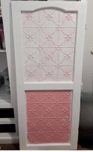

Cut pressed tin to fit inside the door frames. Try to be as accurate as you can but it doesn't have to be perfect. Do not attach at this stage.
Apply two coats of undercoat to everything including the tin and then two coats of white satin paint to everything except for the tin. Paint two coats of the dark pink to the tin. Once dry, adhere to the doors with liquid nails.
Step 3
Apply beeswax to the tin with a rag to areas you want to keep pink then stipple white paint until you have the desired effect. Wipe off excess beeswax with a clean rag. Reattach the doors to the wardrobe.

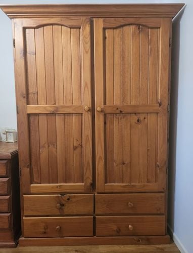

Before
