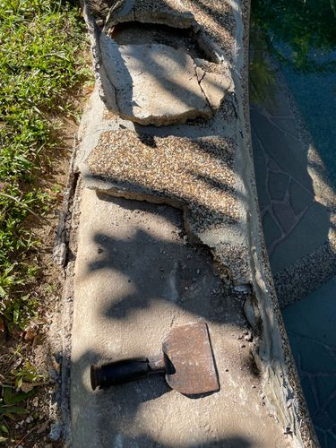

Would like to repair existing pebblecreat at my swiming pool that is above water level and a support on this matter would be appreciated. Especially what material to use and how to install it.
Please refer to the photo attached. Thanks

Unfortunately, I am not aware of a product that is suitable for this kind of repair.
You may need to contact a pool resurfacing specialist for assistance with this. You might like to use a service such as HiPages or True Local to find someone in your area who can assist.
Allow me to tag some of our helpful members who may be able to offer some guidance, @Dave-1, @CSParnell, @Nailbag.
@JacobZ @grabovickic
This thread my help
https://www.workshop.bunnings.com.au/t5/Outdoor/How-to-use-pebble-resurfacer-on-concrete/td-p/55152
Hi @grabovickic a mate of mine up in Cairns is currently dealing with a similar issue with his rental property that has a pebblecret pool. He bought one of these repair kits and has been quite impressed with the results. I don't know the extent the kit will cover with regards, to your issue, but might be worth a look as a starting post.
Regards, Nailbag
Evening @grabovickic
After I had been looking up pebblecreate using google I started getting adds withing facebook land for a product that definently seems useful. I did like the page but cant find it atm 😕 Will keep on looking tho.
I did find this company that may be worth a look at as they have a tab for pool surrounds.
Stoneset Australia I have not used them so cant say how good they are but worth a look.
I once repaired my pebblecreate using a concrete glue and putting he broken chunks back like a jigsaw puzzle. It came up resonable 🙂
