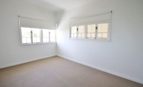

Step 1
photo before. This was taken by the real estate, during the sale before I bought the house. Does not show how terrible the walls and windows were, but you can still tell its old.

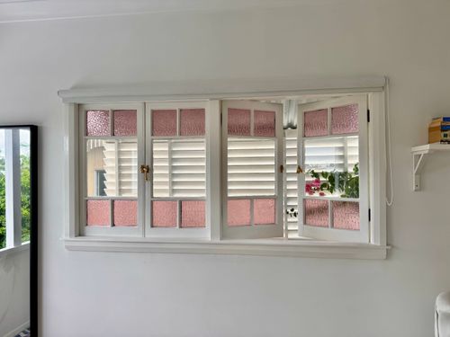

now the hard part. Windows!

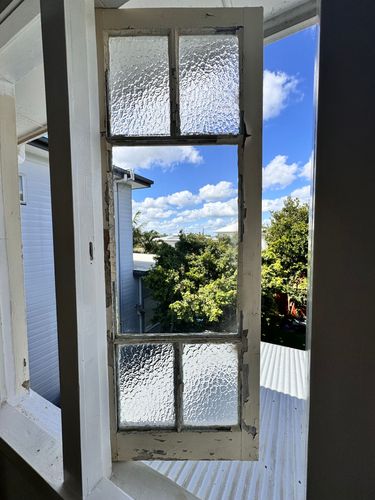

removed all 8 windows and sanded frames and sills. This part took several days.
Bunnings- Ryobi orbital sander and 40 or 60 grit paper
Chiseled out putty and removed glass. There are 40 panes of glass in this bedroom!
Took primed frames to glazier and had new glass cut. I choose Pink Florentine to both restore the charm of the house and give my daughter a beautiful rose hue inside her room.
Puttied all glass into the frames. Installed new matt black hinges.
Installed windows into sills which is pretty hard to do alone FYI. (I would recommend finding help on this step.)
Installed polished brass window hardware.

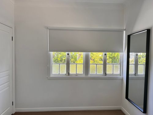

Step 7
windows when finished
