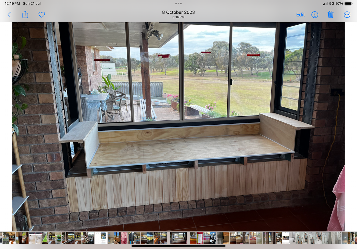

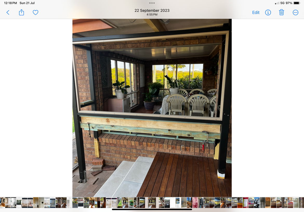

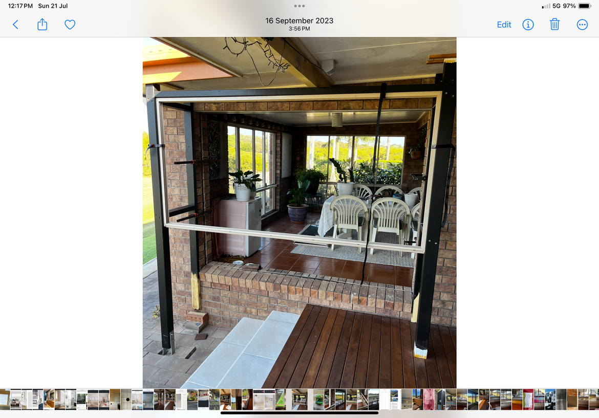

Removed existing window. Positioned posts and framed up the new window position, louvres, bed and shelving.
Step 2
Redesigned existing window and along with side louvres, installed them into the frame.
Step 3

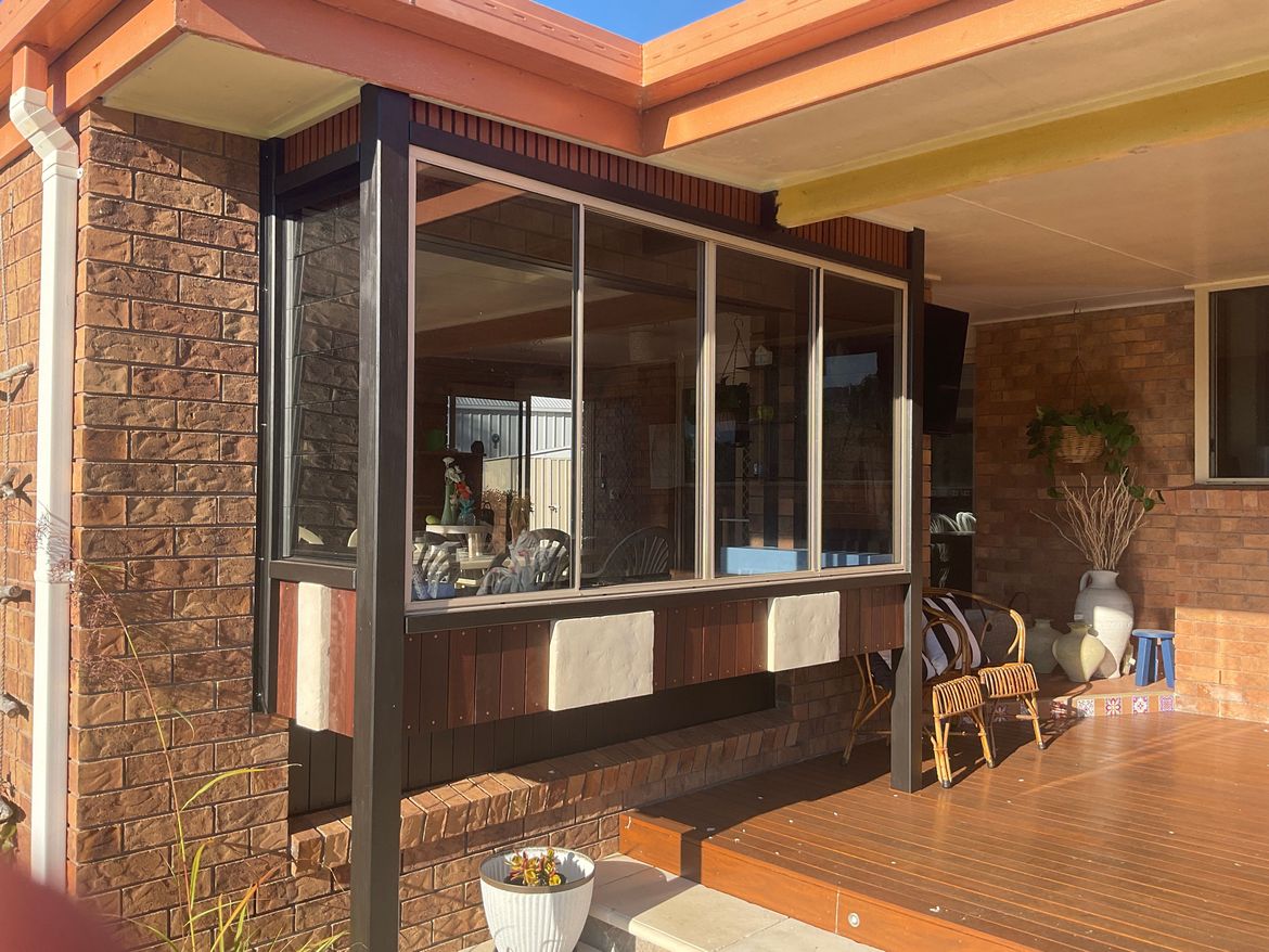

Finished off the bed base and side timber shelving, installed inside and outside cladding and painted and oiled the timber.

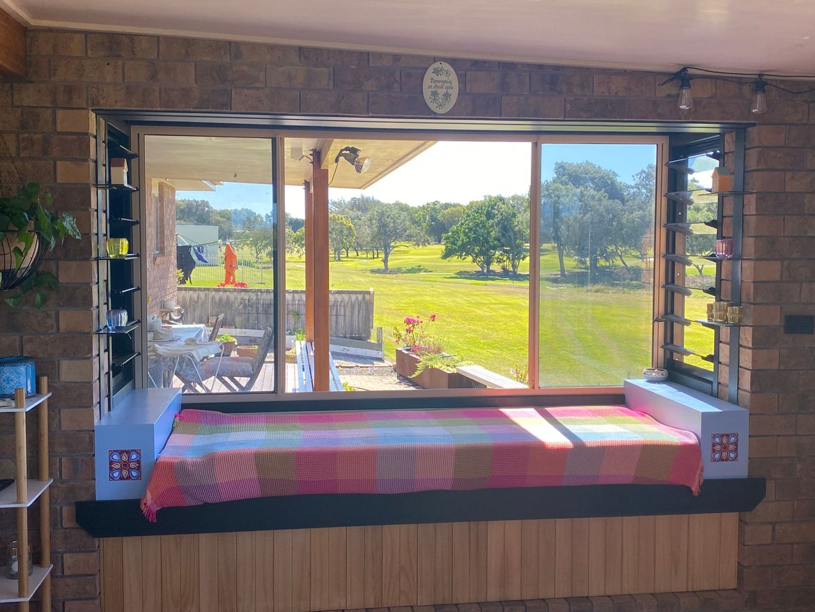

Finishing touches with coloured patterned tiles, and glass wall shelving.
