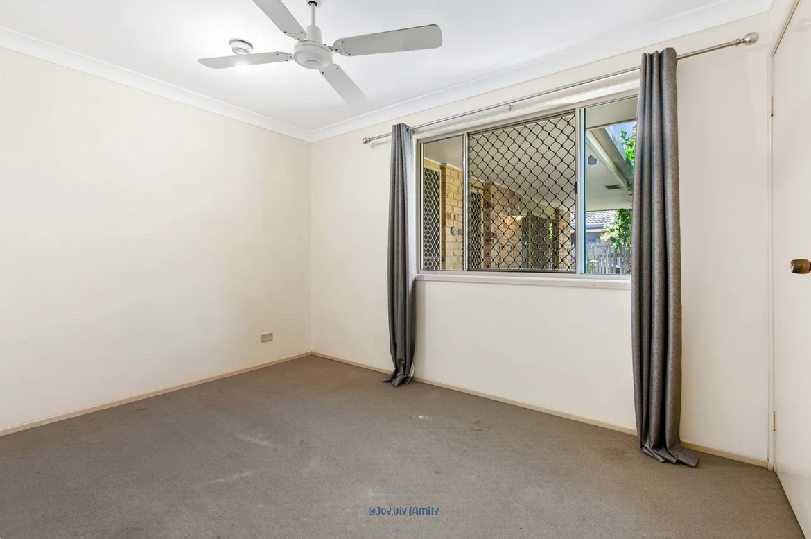

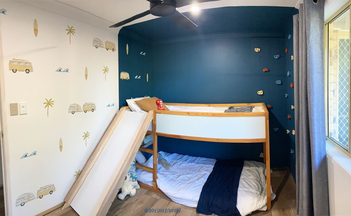

Boys bedroom with a slide and a climbing wallThe boys already had this Kura bed from Ikea, this time they wanted a slide that we put on top of the ladder, so to climb the wall we created a climbing wall on the corner of the room. We created a niche painting the walls/ceiling in a dark blue colour. We painted the climbing rocks to match with the sticker we already had. We replaced the carpet for a hybrid flooring and replaced the ceiling fan and lighting.

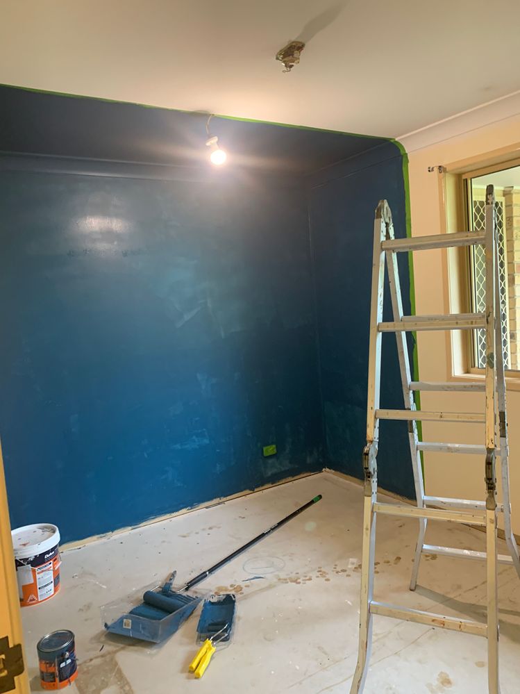

We start painting the walls and ceiling in a dark blue from Dulux.

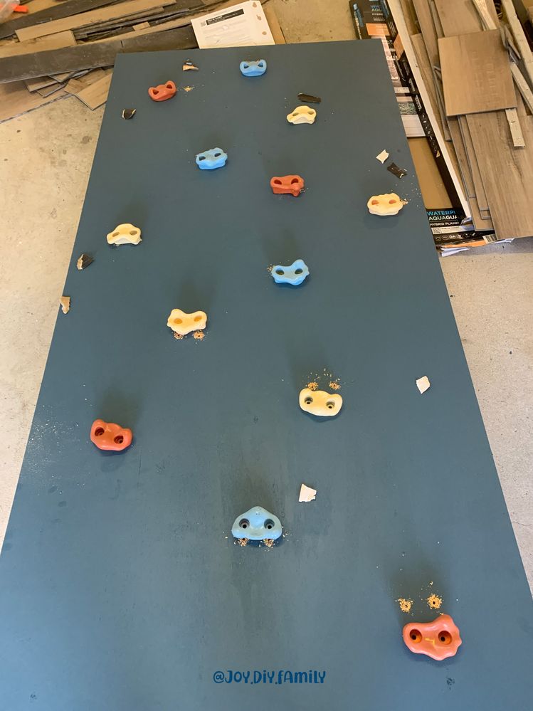

We spray painted the climbing rocks, then attached them to a 20mm plywood.

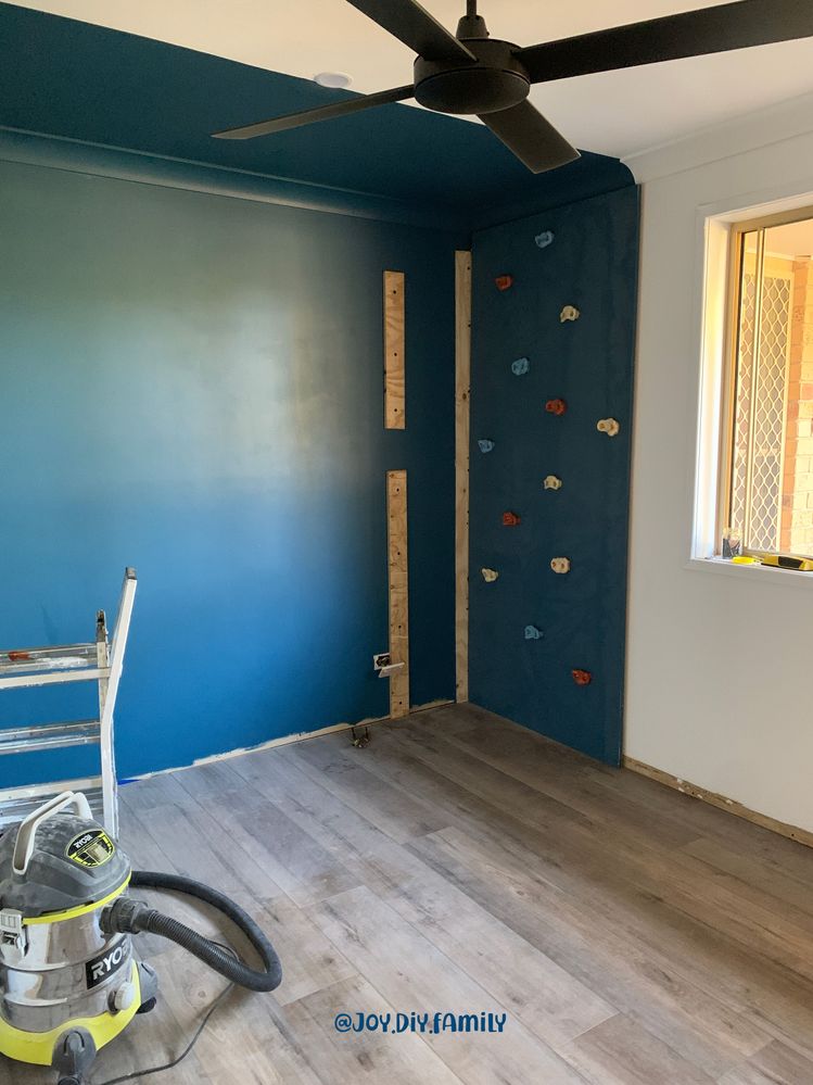

We attached some timber to the walls, screwing them on existing studs.

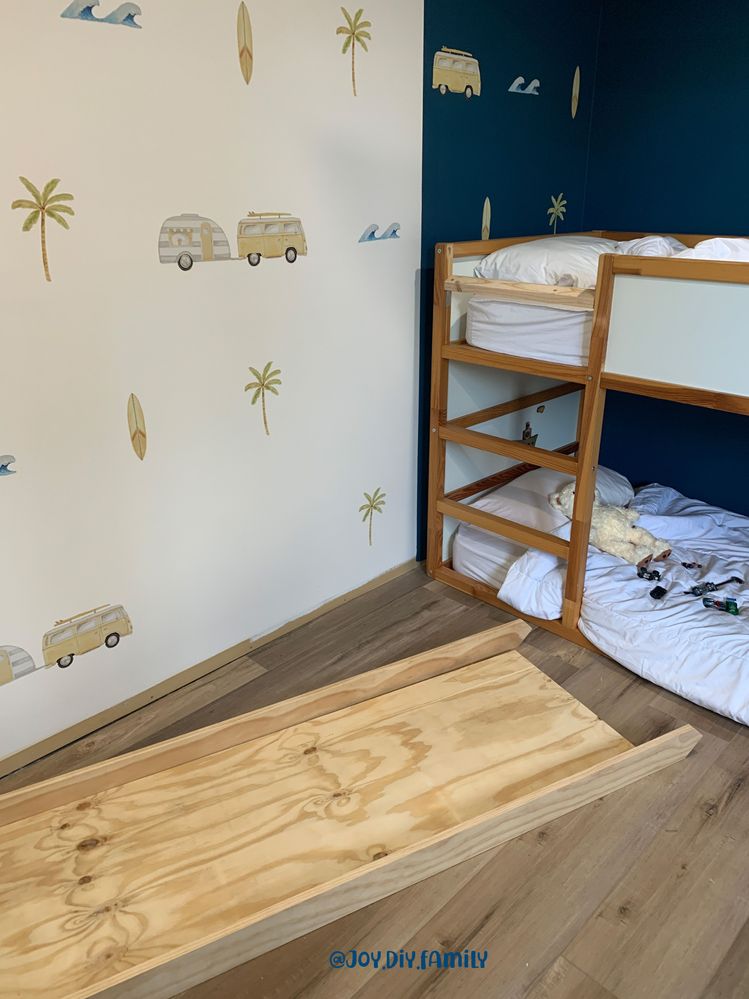

To the slide we used the same plywood, just attached some timber on the sides and a 3mm white backing board on top glued with liquid nail to make it smooth, the boys asked to be quite steep. We used a handrail profile to finish.
