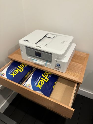

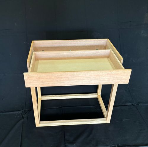

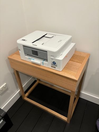

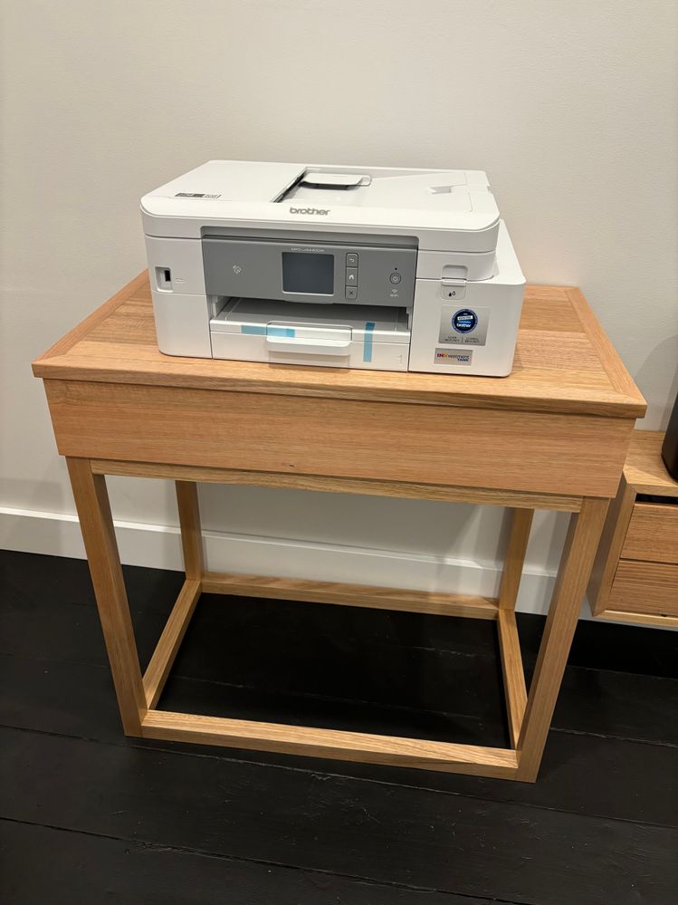

I have recently purchased a new printer, so I needed a printer table, this is the result, made from solid Tasmanian Oak timber.

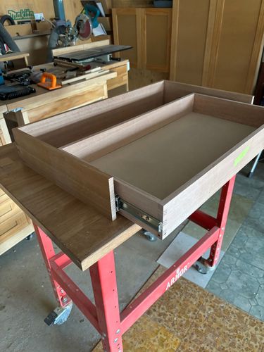

i first made the carcass for the drawer and also made the drawer to fit, then I made the leg/base frame to suit, the final part made was the table top. Finished in satin water based varnish.

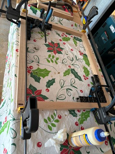

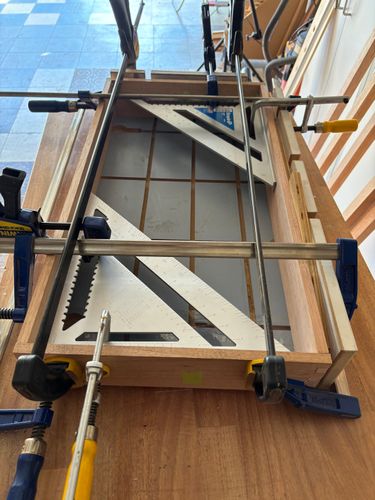

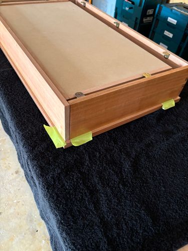

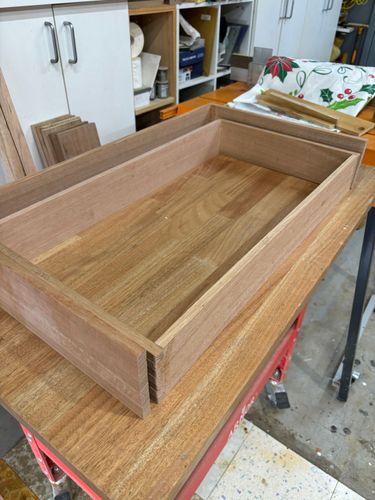

Make up carcass and drawer, I like using box joints for joint the timber, I think it’s a strong joint and easy to make.

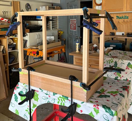

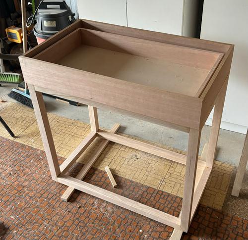

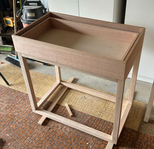

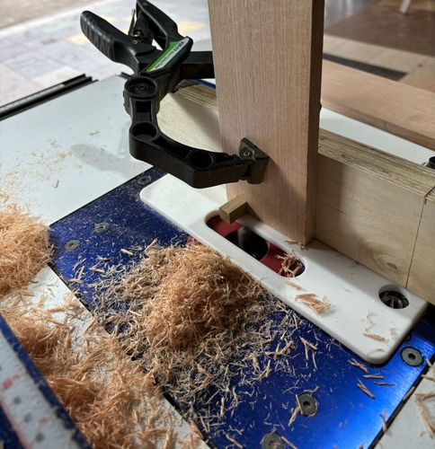

I then made the base frame for the drawer section

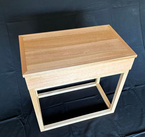

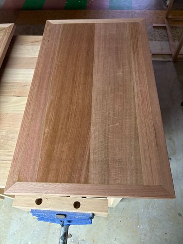

Final step , I made the table top, using 19mm x135mm timber for the top and 19mm x 35mm timber for the edging
