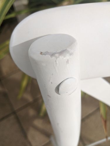

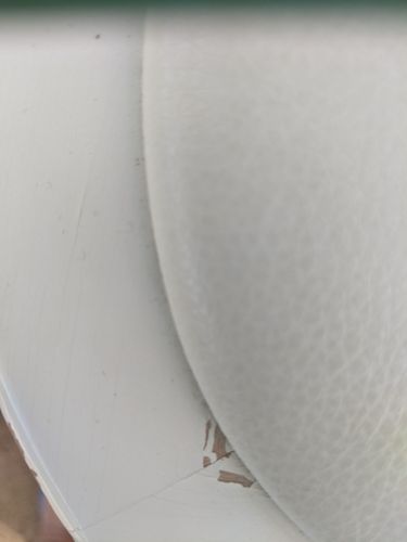

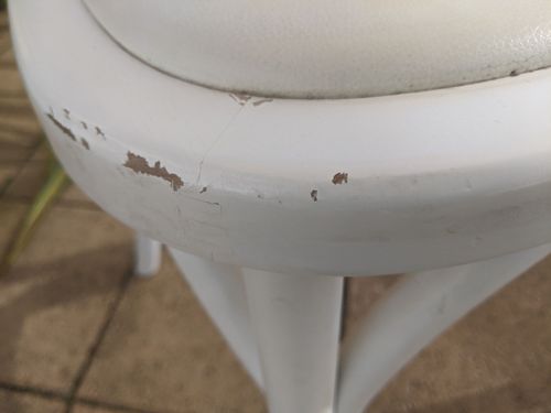

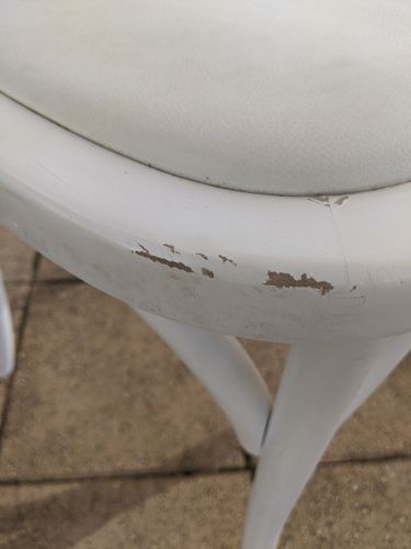

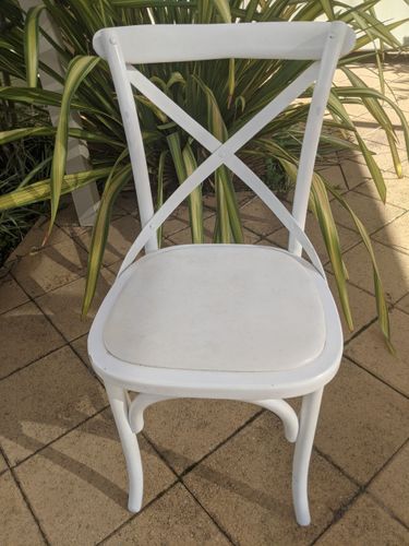

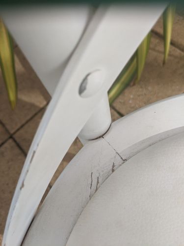

I have 6 chairs that either need repainting or just a touch-up. What paint should I use to give a smooth finish to look like I just bought them. Thank you.

Thanks for sharing the picture of your chairs. It appears that the paint is starting to chip off and could be caused by wear and tear. I suggest investigating the bottom of the chair and see if the foam seat can be removed by itself. If it is anchored to the chair, you'll need to mask the soft chair material with painter's tape and cover the top with paper or plastic to prevent paint from getting on the seat.
I propose doing a sanding test on the chipped area and around the body of the chair. If the paint comes off too easily, it will be necessary to remove all the paint. But if the paint is still solidly attached to the chair, a vigorous sanding should suffice. I recommend using Dulux 1Step Prep Primer, Sealer & Undercoat 1L and for the topcoat I recommend Dulux 1L White Aquanamel High Gloss Enamel Paint. Both these paint products are water-based and should be safe to use on your chair.
