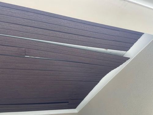

how do I fix this ?

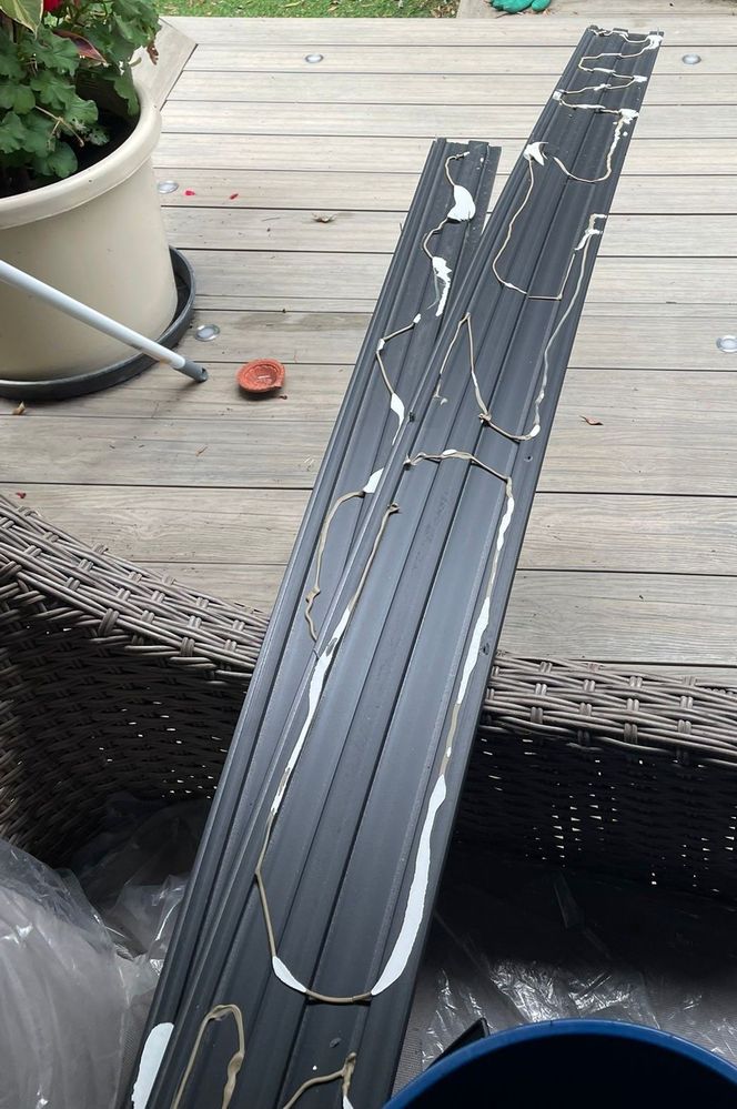

Hi @phonesrbest,
Looking at the glue on the piece that has come off, you can tell it wasn't compressed as it is still in the shape it would have come out of the tube. There also wasn't really enough used in the correct place.
Use Liquid Nails but apply it along the ridges that will make direct contact with the ceiling. I have highlighted what I mean below.
Any liquid nails applied between these ribs is essentially wasted as it won't actually touch the ceiling.
Apply a long bead of liquid nails along these three ribs and press it onto the ceiling so it is compressed and creates suction.
You can then use a prop such as this Gorilla 155-290cm PIHER Adjustable Multi-Prop to hold them in place while the glue dries.

Good Evening @phonesrbest
Yes you will need to have some kind of prop to hold the piece in place while you wait for the liquid nails to go off. Or you could put some screws throught it into the roof. The beads of liquid nails dont really seem to have made contact with the tin and the roof, you can see the flat area on parts of the beads, that is where its been compressed and will bond, the places where you can see the run of the liquid nails without being squashed effectivly wasnt doing any holding of the roof.

hi JacobZ, Previous owner did the same what was suggested by everyone in this thread - liquid nails and nails. What went wrong here? less liquid nail or fewer nails ?

please see the image

@DIYGnome's advice is spot on.Apply a bead of Liquid Nails to the back of the panels and push them back into place.
The liquid nails will hold well, but ideally you would use a Trim Master Gas Bradder to shoot some brad nails into the studwork above.
Where a stud isn't available, two nails can be shot at opposing angles at close proximity to give some good holding power into the plasterboard.Let me know if you have any further questions.
