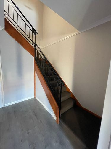

Im hoping to take this orange tint out of the wood, I think it has an oil stain on previously.
anybody know if I can lighten it to an Ash colour without sanding?

Unfortunately the only way to lighten the timber is to either sand it right back to the raw timber or apply a primer and paint it as the darker colour will always bleed through. The high polished oil/varnish thats on the timber now means that nothing you directly apply will stick directly to it.

It's great that you've received excellent advice from @brendawebster44 and @Nailbag. I'm sorry, but I'm afraid there is no escape from sanding your timber surface. To make the job go faster, I suggest using an electric sander. Once all the old sealer has been removed you can then choose from the stain and varnish sets available at the store.

Hi @linds_saun should you choose to go down the sander route, then I would recommend a "Random Orbit Sander" as these offer a very efficient sanding system in either electric or battery power. This job will take some time, so an Electric one would be best. Start with an 80G paper to get most of the stain out, then move to 120G and 180G or 240G and finish all edges by hand. Getting in the corners either with a sanding block by hand or a detail sander.
