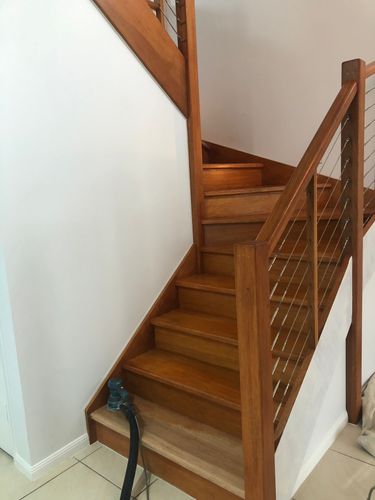

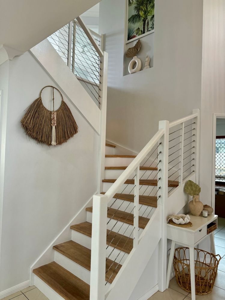

i sanded back the old varnish to reveal the beautiful natural blackbutt. Left the treads natural and painted the rest white

Started with the orbit sander then used paint stripper and scrapers to get into the corners.
went over with a light sand and wipe over with sugar soap
primed the areas that would be painted, then 2 coats of paint
