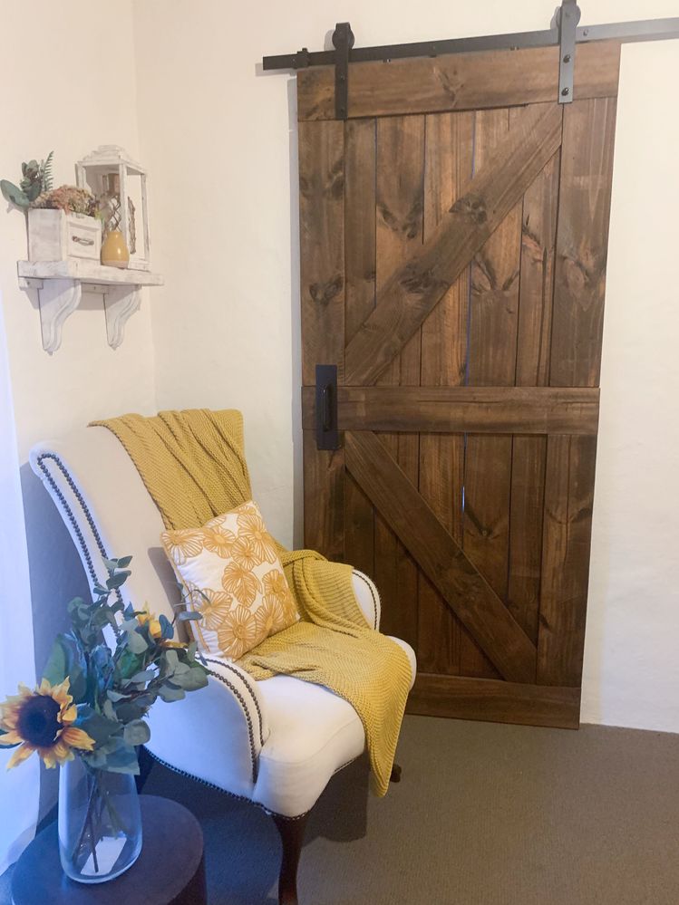

Rustic Bedroom Barn DoorWe had an opening into the walk-in-robe, and lots of wall space to the side, so I thought it was the perfect place to add a bit of style with a barn door. I used fence panel timber, which although seemed very dry as it had been in my workshop for ages, still shrunk later on. It didn't matter for this particular door, and I personally love the uneven rustic-ness of it, but I would recommend fully-dressed dry timber if no gaps is important to you.

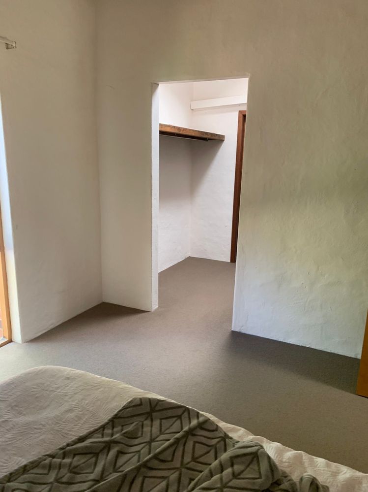

How bare the room looked before.
Before Photo

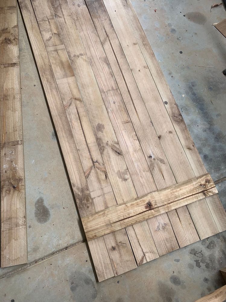

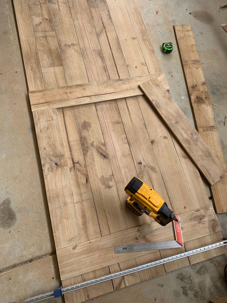

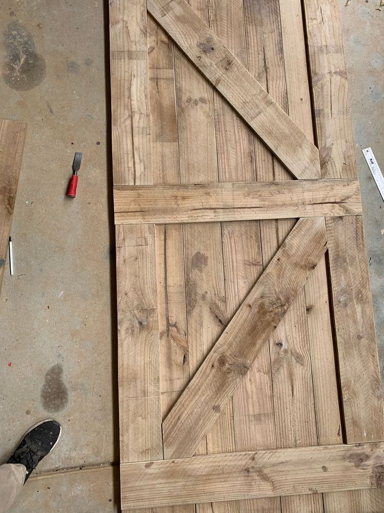

Just a case of laying out my design and cutting the timber to size and assembling all with a nail gun. Quite quick and easy.
